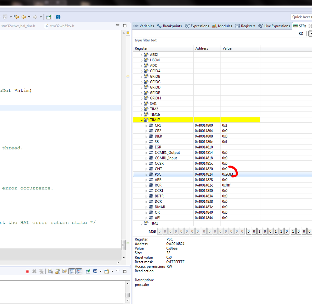

I enable counter by __HAL_TIM_ENABLE(&htim17);
and I see in debugger that PSC register incrementing, not CNT. CNT is always zero. Are the registers messed up?
Settings are from CubeIDE 1.41 with stm32wb pack 1.8:

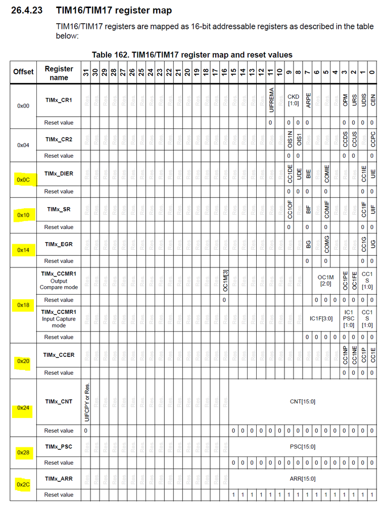

It appears the SVD file is incorrect on quite a few of the registers. The error starts at DIER which should be at 0x0C.

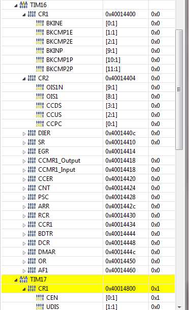

If @TDK​ 's table is for Tim16 and Tim17, then TIM16 looks strange, isn't it? Where is CEN bit of CR1 in TIM16?0693W000003BtHQQA0.png
It's bit 0 of CR1, right there in the table. Seems fine to me.
Edit: Oh, now I understand.
Agreed, CEN is missing in the SVD file as well (but the table seems correct).
