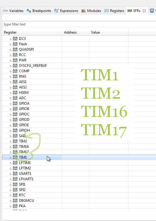

I enable counter by __HAL_TIM_ENABLE(&htim17);
and I see in debugger that PSC register incrementing, not CNT. CNT is always zero. Are the registers messed up?
Settings are from CubeIDE 1.41 with stm32wb pack 1.8:

I check for TIM17. SVD files by @Imen Ezzine​ is correct. But in 1.9.0 pack there are old SVD files.

‎2021-11-08 10:04 PM
It's time to make true order with stm32wb!

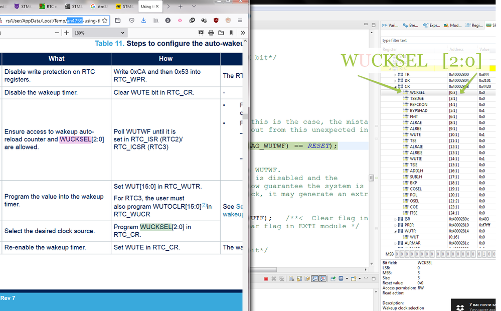

Also check RTC registers!
