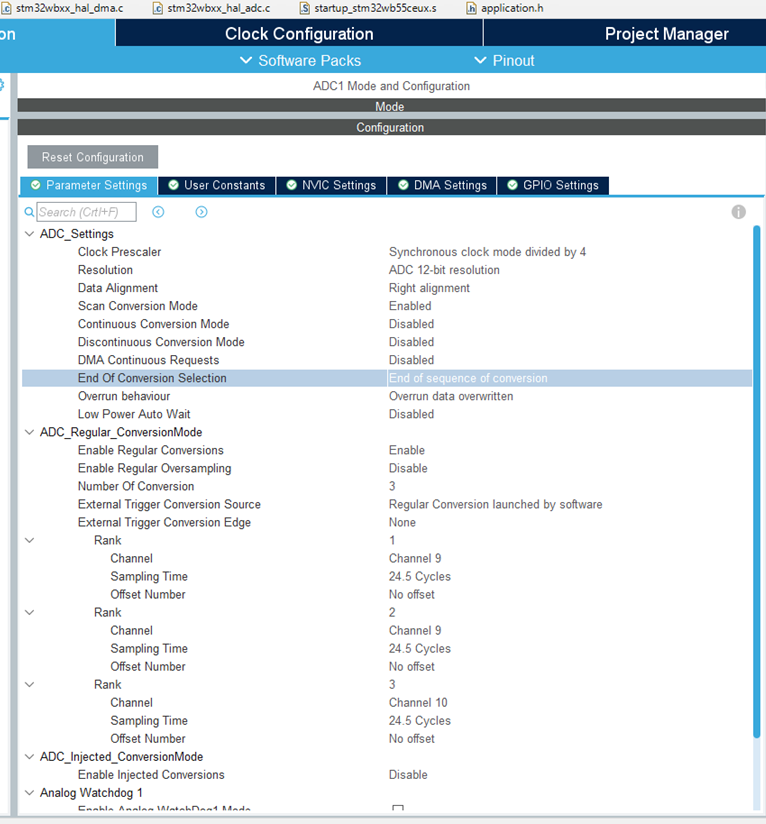

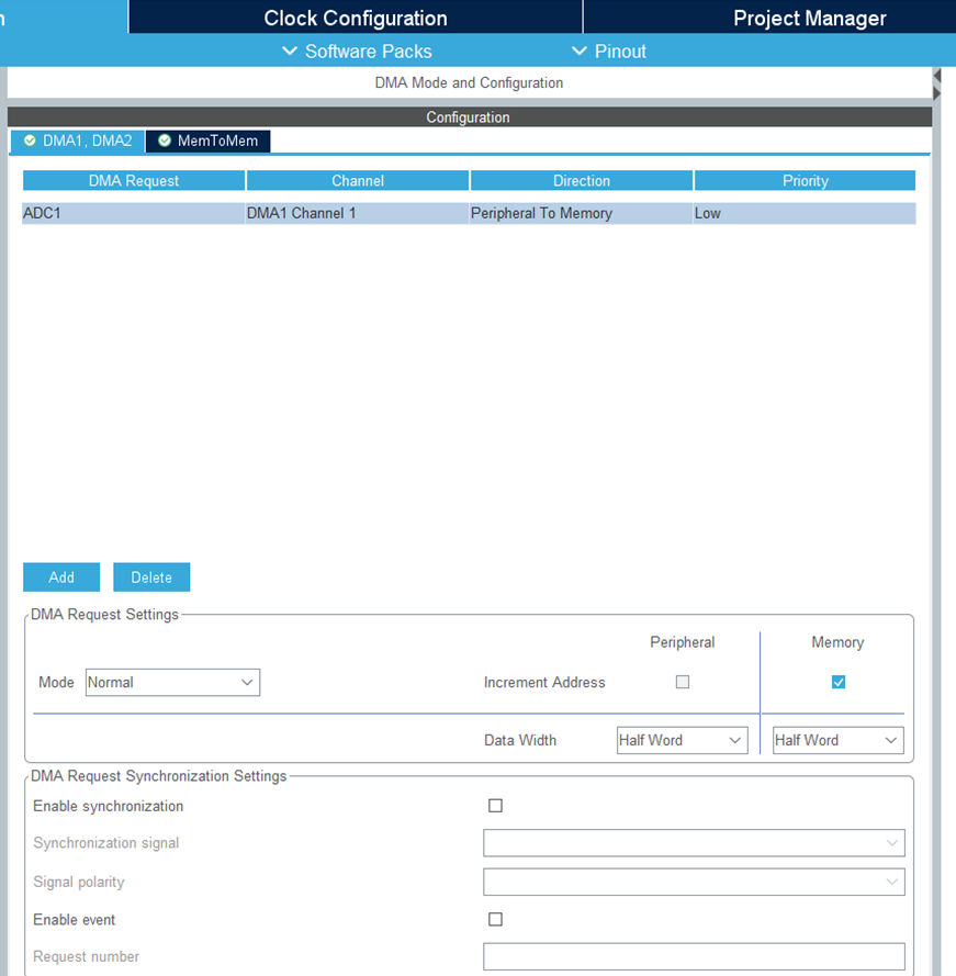

Trying to trigger scan mode (2 channels but 3 conversions ---- A/D 9, A/D 9, A/D 10) via software trigger that is called in the LPTIMER (I do not have access to other timers bcz they are tied up in other code that is why I am not using a trigger output) callback function. Can someone see something I am missing as the adcValue array is always empty ?
ADC CubeMx settings:
DMA CubeMx settings:

Thank you.....

Hi @SWenn.1​ ,
I see a follow-up of your question here.
If it is still open, please make sure that HAL_DMA_Init() is called before HAL_ADC_Init()?
It is probable that you face this regression issue if you aren't using latest STM32CubeMX version (6.4).
Some more details in this post.
-Amel
