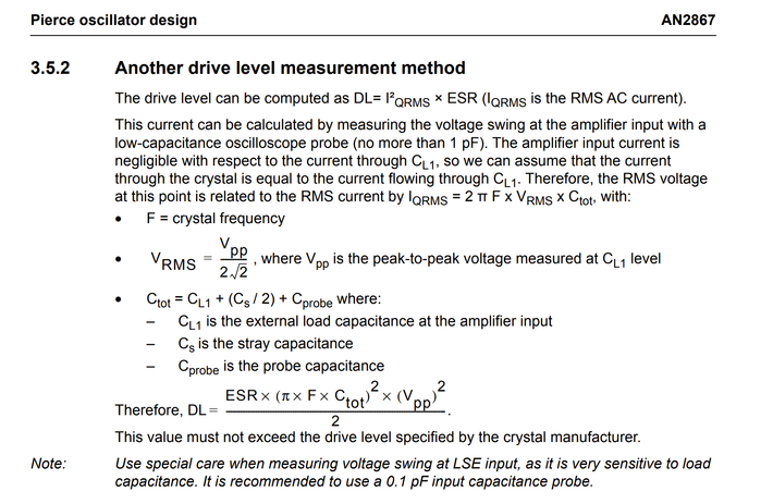

Measuring drive level is not so difficult when using an active probe:
(AN2867 Rev 23 page 16)
Anyway, I’ll measure the DL to ensure everything is within spec when set to max level.
