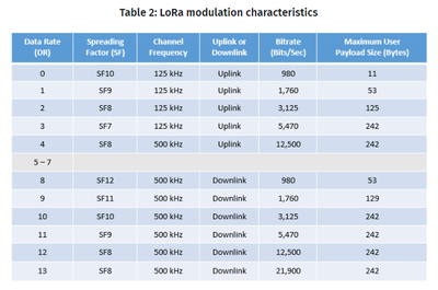

@Yuvi wrote:
I fill a 242-byte buffer and try to transmit data it only transmits data at SF7 and SF8 and not at SF9,10,11,12. At this SF I'm getting empty packets
The over-the-air payload size is significantly smaller at the higher spreading factors - maybe the problem is in your splitting of that "large buffer" ... ?
https://lora-developers.semtech.com/documentation/tech-papers-and-guides/lora-and-lorawan/
EDIT:
It also affects time-on-air - so perhaps your transmission is being blocked due to time-on-air limits ?

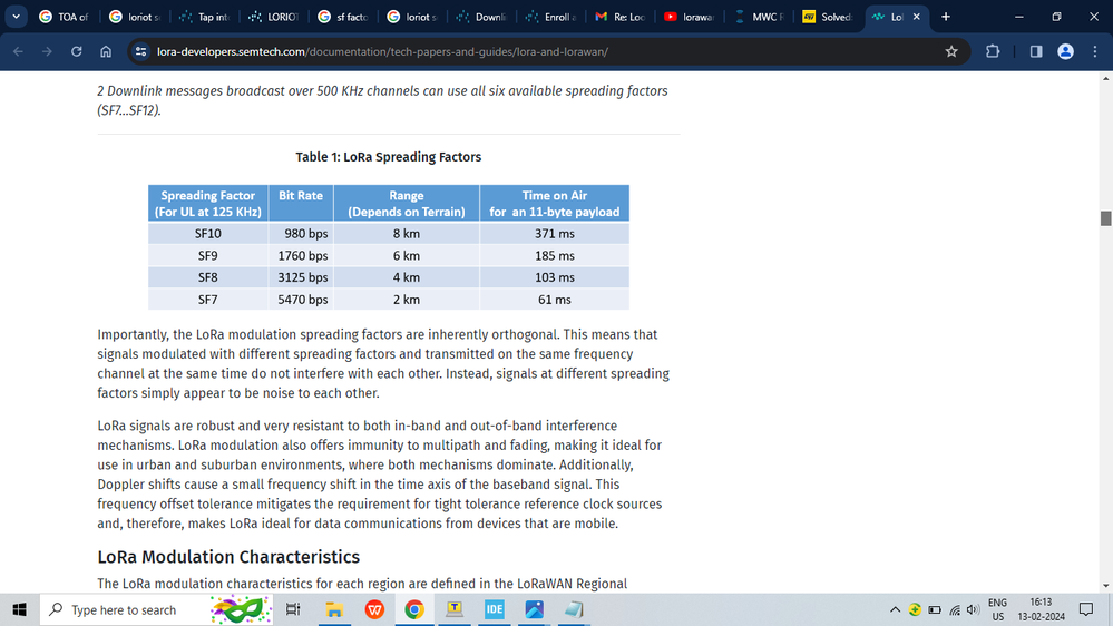

Thank you for your response @Andrew Neil
I got your point, and as this picture/google says we get SF7 till range of km. But as I go beyond 50 meters SF drops from 7 to 12. How can I get a better data rate with a range of 1 km?Screenshot (5).png
