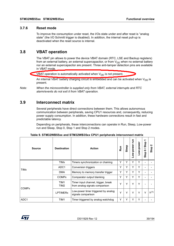

I'm developing STM32WB55VQ power system but I wonder the microcontroller automatically use battery power or not when Vdd is cut.
Is there anybody can explain this?
again, that's all answered in the datasheet.

waclawek.jan
Can I use secondary battery for Vbat connection? if possible what happen when power is supplied by battery charger to battery?
waclawek.jan
What do you mean by secondary battery? An accumulator?
You can use accumulator for VBAT. In some STM32 (I did not check for WB) there's even a provision for trickle charging (a switchable resistor from VDD to VBAT).
If the charger does not exceed the maximum voltage for VBAT stated in the datasheet, it is OK.

VBAT pin supplies only RTC.
Read an answer Andrew's questions above.
There's no provision to switch between different VDD sources, and they must not exceed voltages given in DS. Design of VDD power source is entirely upon you.
