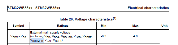

The STM32WB55 microcontroller have SMPS internally.
Can I use it to convert AC power to DC power for the microcontroller?
If possible, I want to supply RF inductive charging power directly to the microcontroller.
it tells you that the minimum input is, essentially, zero - so you can't apply AC.
Therefore you would need to provide any rectification externally.
The datasheet also tells you that it is a step-down SMPS, so it wouldn't be able to cope with a rectified AC supply - which drops to zero once (half-wave) or twice (full-wave) per cycle.

Absolute Maximum limits:
No. My question is whether SMPS in microcontroller can be used for AD-DC converter but, it is not in manual.
Go on.

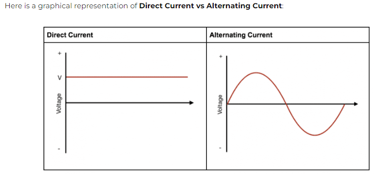

It clearly tells you that the minimum input is, essentially, zero and the maximum is 4V; so that can't possibly be AC - can it?
0693W00000QKfGEQA1.pnghttps://www.circuitbasics.com/what-is-alternating-current/
Yes. It would be true. However, if there is a diode, I can apply half-wave but still, information is insufficient because I don't know that the SMPS has a bridge rectifier inside.
