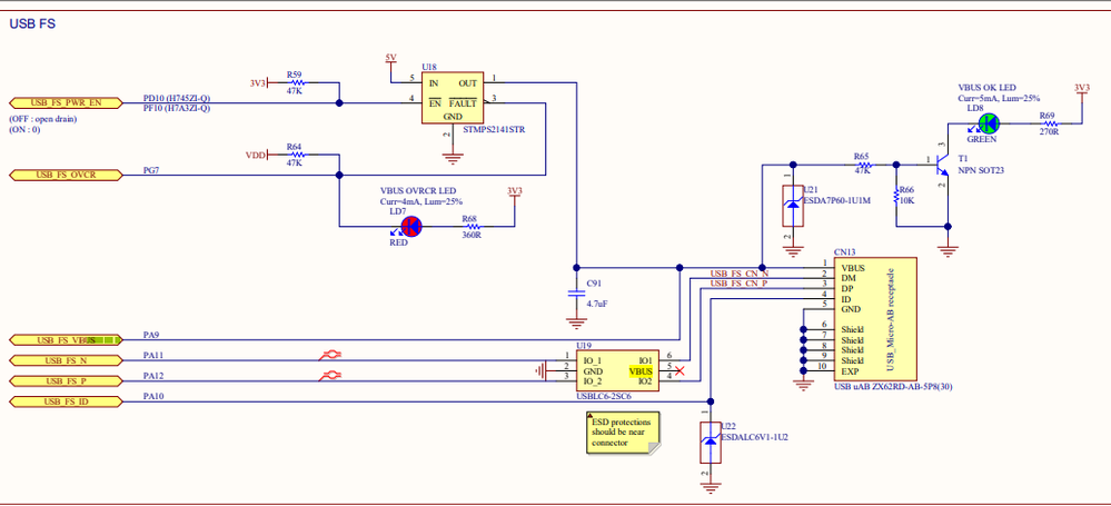

>When STM32 is configured as Host mode, should the STM32 source 5 V onto VBUS?
when STM32 is configured as host you need to configure a specific pin as output (based on your product) to power the device part through the Vbus sensing pin
for example PG7 if you are using Nucleo-H755 :

waclawek.jan
Which STM32?
There is no way any STM32 can *source* 5V.
VBUS is input to a comparator, its output can be read as a bit in some of the OTG registers, and if set as interrupt source, it can trigger that interrupt. That's all. Now how you treat this signal/bit/interrupt in your code - and "your code" includes any library you are using - is up to you.
Note, that voltage on even 5V tolerant pin must not exceed 4V against VDD, even when the mcu is powered down.
You may want to check schematics of some of the STM32 demo boards such as Disco, for inspiration.

Hello @afedffwerf

>I would like to know whether a design where VBUS is always supplied by an external 5 V source is suitable for STM32 USB OTG operation, and what the recommended hardware implementation for VBUS control is.
Well first, like @waclawek.jan the voltage on even 5V tolerant pin must not exceed 4V against VDD.
It should work, since in most cases we don't even enable Vbus pin(PA9) in device mode functionalities
You can use one of our reference boards schematics as reference
and in general, to understand more the ID pin detection and Vbus sensing concept and their implementation in STM32 products you can read the USB_OTG section in this reference manual for example
