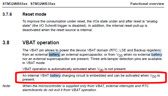

If the power is cut, is the micro controller use battery power automatically?
KKIM.6
Senior II
I'm developing STM32WB55VQ power system but I wonder the microcontroller automatically use battery power or not when Vdd is cut.
Is there anybody can explain this?

@KKIM.6​  " I didn't know that the wb55 can charge battery."
Really? it's clearly stated in the datasheet:
0693W00000QKdHjQAL.pngBut note that's only the backup battery/supercap - not any main system supply battery

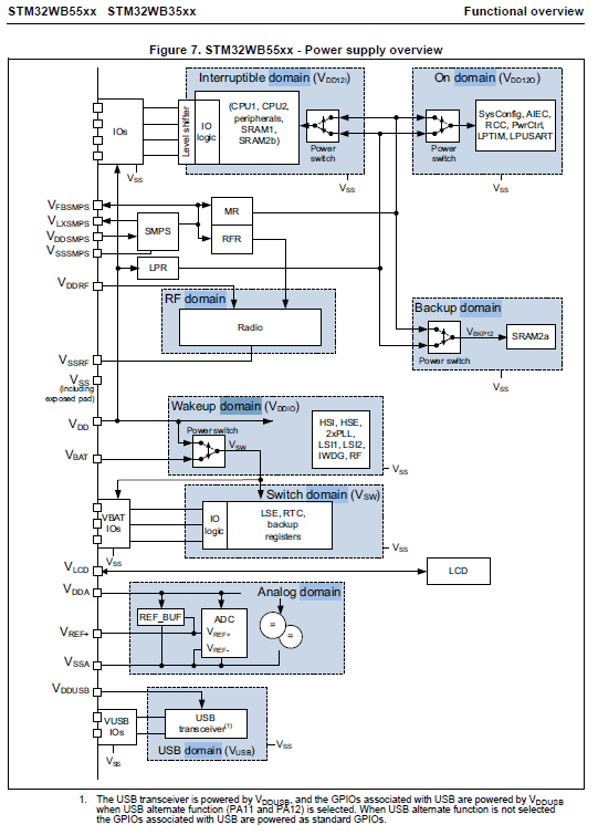

Note also this diagram showing the different power domains - ie, what gets powered from which supply pins:
0693W00000QKdIcQAL.png@Community member​ "the Data Sheet, might be worth a review"

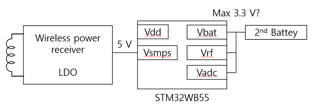

My final question is whether the power line below is possible or not.0693W00000QKfCgQAL.png
If it is possible, I don't need PMIC/battery charger between power receiver and microcontroller.
again, that's all answered in the datasheet.

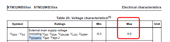

I wonder what's happen if apply more than 4 V.​

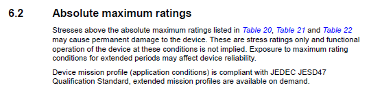

Again, the datasheet tells you that.
The 4V is the Absolute Maximum rating; the datasheet defines that term:
