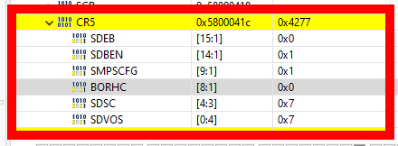

I found some bug in STM32CubeIDE. The bits in the PWR_CR5 register that STM32CubeIDE shows do not match RM0434

Hi @Maxim Shylo​ ,
I confirm the issue: PWR_CR5 is wrongly described in the svd file.
I reported this issue internally.
Internal ticket number: 130639 (This is an internal tracking number and is not accessible or usable by customers).

Hello @Maxim Shylo​ ,
This issue is fixed in STM32WB System View Description version 1.2.
Thank you for your contribution in the STCommunity.
