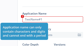

TouchGFX does not support the hash sign in project names. Try to replace it with either a dash or an underscore.
I haven't been able to find a specification of which characters are supported. However, you can test character compatibility when creating a new project. If the rules are violated, TouchGFX Designer prompts you with an error.

When I shortened the path - and the issue went away - it was when I unknowingly removed the # from path that cured the problem. I'll ensure I don't add # to the pathway in the future.
I did know that # was not allowed in the application name, but didn't "twig" that it applied to the whole path.
