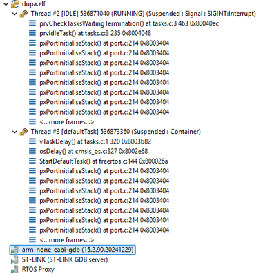

Freertos backtrace problem
  • November 23, 2025
  • 716 views
STM32CubeIDE 2.0
fresh project
with
GNU Tool for STM32: 14.3.rel1 :
GNU Tool for STM32: 13.3.rel1

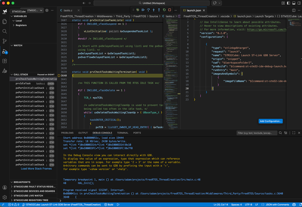

Hi @PKurz.1,
Spotted similar behavior in STM32CubeIDE for VS Code... Made me wonder what is the root-cause?! Then the team informed me about this thread from you. We are facing the same issue...
As you can see the stack unwinding is a bit broken... showing multiple entried of pxPortInitialiseStack.
Google is your best friend... Found this post on FreeRTOS forum:
In a nutshell you can get a better (but not perfect behavior) by defining:
#define configTASK_RETURN_ADDRESS NULL
It seems that nobody have found the "perfect solution". I am not an expert on neither GCC/GDB nor FreeRTOS. Hence I took a pragmatic approach to try to find some work-arounds:
In STM32CubeIDE for VS Code I can easily switch different bundles that I want to use when compiling/debugging my project without hacking my environment. GDB and GCC is delivered as 2x different bundles. So I configured my FreeRTOS projects to build and debug the FreeRTOS application with these combinations of bundles:

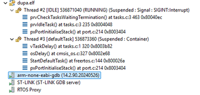

  • Test1: GCC-13 + GDB-13   =    OK
  • Test2: GCC-13 + GDB-14   =    OK
  • Test3: GCC-14 + GDB-13   =    FAIL
  • Test4: GCC-14 + GDB-14   =    FAIL
It seems that GCC-14 is the common denominator in all casese where debug stack unwinding is "faling"?!
This seems to be an "up-stream" bug, should be solved "up-stream"...
