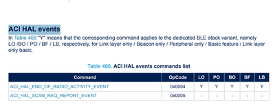

Option 1: AN5270
The enable event :  ACI_HAL_SET_EVENT_MASK
The event message:  ACI HAL events
Both seems not to be enabled ( no "Y" on any of LO, BO , BF etc... ) . What does it mean ? Will they work on full stack ?
Option2 : AN6142/AN5270
The enable event :  HCI_LE_SET_EVENT ( I guess puting : • 0x0000000000040000: LE scan request received event  will do the trick?)
The event message:: HCI_LE_SCAN_REQUEST_RECEIVED_EVENT  is enabled only for LO ? will it work on full stack bin?

STTwo-32
Hello @DS.4
If the correspondent commends is not supported on the mentioned BLE stacks, you have to use the stm32wb5x_BLE_Stack_full_extended_fw.bin. To know the stack you should use, you have to follow this table:
Best Regards.
STTwo-32
