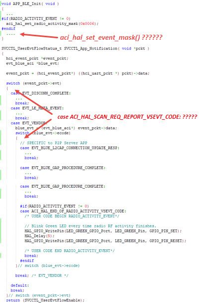

Recently I started working with Nucleo board with STM32WB55 and I would appreciate if somebody could help me with this issue about BLE. I never worked with the BLE stack before and I am quite lost and confused.
I am working in a project where I only need to detect the SCAN REQUEST. In the learning process of STM32WB, I found the very useful MOOCs and more specifically “STM32WB Workshop – 3 How to add BLE funcionality�?. It Works with the project “HandsOn2�? supplied by ST.
https://www.youtube.com/watch?v=zNfIGh30kSs&list=PLnMKNibPkDnGRfqUO1Q_-1nW-tOKfDQbc&index=4
Among other things, it explains how to blink a LED every time a radio RF activity finishes, using Radio Activity Event. I thought following the steps of this event would be a good way to get a SCAN REQUEST event, but unfortunately so far I have not achieved anything.
Please find below the pseudo code of app_ble.c file, where the radio RF activity is mentioned.
-         In the APP_BLE_Init() funtion the radio activity event mask is defined:
aci_hal_set_radio_activity_mask(0x0006);
-         In the SVCCTL_App_Notification() function you could find ACI_HAL_END_OF_RADIO_ACTIVITY_VSEVT_CODE, and here is where the previously mentioned LED blink is set.

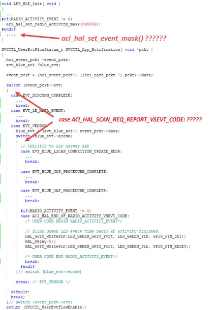

So, how should I define scan request event mask?.
Should I use aci_hal_set_event_mask()?
In that case, should it be aci_hal_set_event_mask(5) or aci_hal_set_event_mask(1)?
Where should I locate case ACI_HAL_SCAN_REQ_REPORT_VSEVT_CODE: in switch (event_pckt->evt) or in switch (blue_evt->ecode).
The point is that I tried every combinations but it doesn´t work. I´m afraid I´m wrong and I´m missing something, but I don´t know what? Any help will be appreciated.
