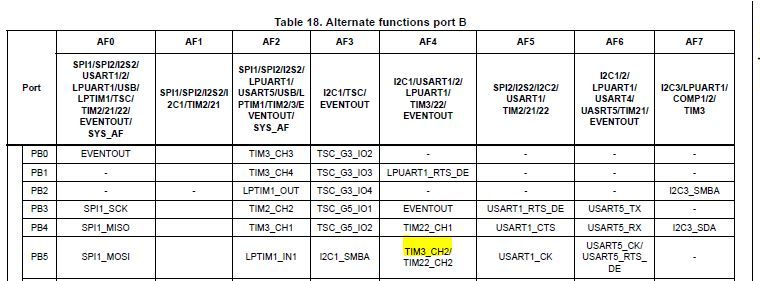

I have generated the code for PWM generation using STM32 CubeMX and it is working fine on B-l072Z-lrwan1.
But when I was trying to integrate same code with the existing Ping Pong example, I was not getting any PWM signal on respective pin. I have also configure the pin according to timer and channel with the help of datasheet and also check the alternate function for the pin.
I have tried different Timers but I am not getting any PWM signal at output.
Can anyone tell me, why this is happening?

Rest of all code is executing well except PWM.
I am generating PWM on PB5 so Green LED Should be dim, but it remains off all the time.

Registers configuration is right because the same configuration individually works fine but not with Ping Pong code.
I can't understand what is the problem ?
Below is the way I configured the registers and pin for PWM.
void PWM_LED_Init(Led_TypeDef Led)
HAL_GPIO_WritePin(GPIOB, GPIO_PIN_5, GPIO_PIN_RESET);
GPIO_InitTypeDef GPIO_InitStruct;
/* Enable the GPIO_LED Clock */
LEDx_GPIO_CLK_ENABLE( Led );
/* Configure the GPIO_LED pin */
GPIO_InitStruct.Pin = GPIO_PIN_5;
GPIO_InitStruct.Alternate = GPIO_AF4_TIM3;
HAL_GPIO_Init(GPIOB, &GPIO_InitStruct);

‎2019-09-13 8:41 AM
TIM3_CH2 on PB5 is AF1
‎2019-09-13 10:01 PM
This is given in datasheet.
