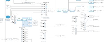

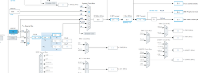

Greetings,
I have acquired Nucleo-U031R8 as I was searching for ULP controllers and specification of this one was good. I am currently trying to lower current consumption as low as possible.
Previously, I have used Nucleo-L073RZ where I was able to achieve approx. 300uA in low power run mode and 150uA in sleep mode. I was hoping to get much lower current consumption using U0 series processor but it seems like it is consuming more power then L0 series.
Note that in both controller program and other peripheral configurations are same. Can someone please suggest why it is happing and what can I do about it?
Thank you so much for the help. @KDJEM.1 @LPetr.1 @TDK

Clock setup:
7 REPLIES 7
JeetS
For the testing I have cleaned all GPIO and peripheral pins but current consumption is 180uA instead of approx. 110uA as you can see in the datasheet (table 28).

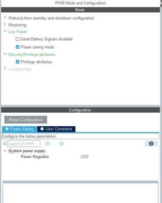

Power settings:
Clock settings:

I have kept all unused pins to analog mode, removed debugging probe and stopped it.
I don't see in this code where you're going in Low-power run mode. Am I missing it?
Include your IOC file if you can.
JeetS
@TDK this function is used to enter in low power mode. right? I have attached .ioc file below.

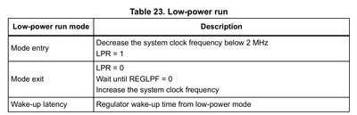

  HAL_PWREx_EnableUltraLowPowerMode();
Let's look at the source and find out:
  * @brief Enable Ultra Low Power BORL, BORH and PVD for STOP2 and Standby modes.
  * @note  All the other modes are not affected by this bit.
  * @retval None
void HAL_PWREx_EnableUltraLowPowerMode(void)
  SET_BIT(PWR->CR3, PWR_CR3_ENULP);
It sets ENULP.
To enter low power mode, based on the table above, we need to set LPR=1.
So no, that doesn't get you there.
You want HAL_PWREx_EnableLowPowerRunMode.
JeetS
Thank you so much for the guidance. I have tried it by replacing HAL_PWREx_EnableUltraLowPowerMode to HAL_PWREx_EnableLowPowerRunMode but it does not seems to lower the current consumption.

Where did you decrease system clock frequency below 2 MHz?
JeetS
Sorry for delayed response, I have changed MSI clock frequency to 800kHz and passing it to SYSCLK. So, my system clock frequency is 0.8MHz already.
Please, refer to the screenshots and .IOC file attached.  @KDJEM.1 @LPetr.1  @Tesla DeLorean @waclawek.jan
you guys have any idea what is going wrong ?
Thank you so much in advance.
