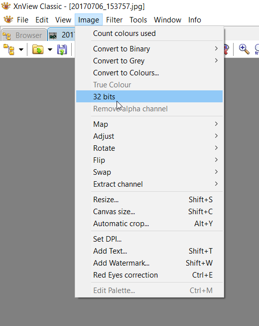

I would use XnView & HxD:
  • Open your image

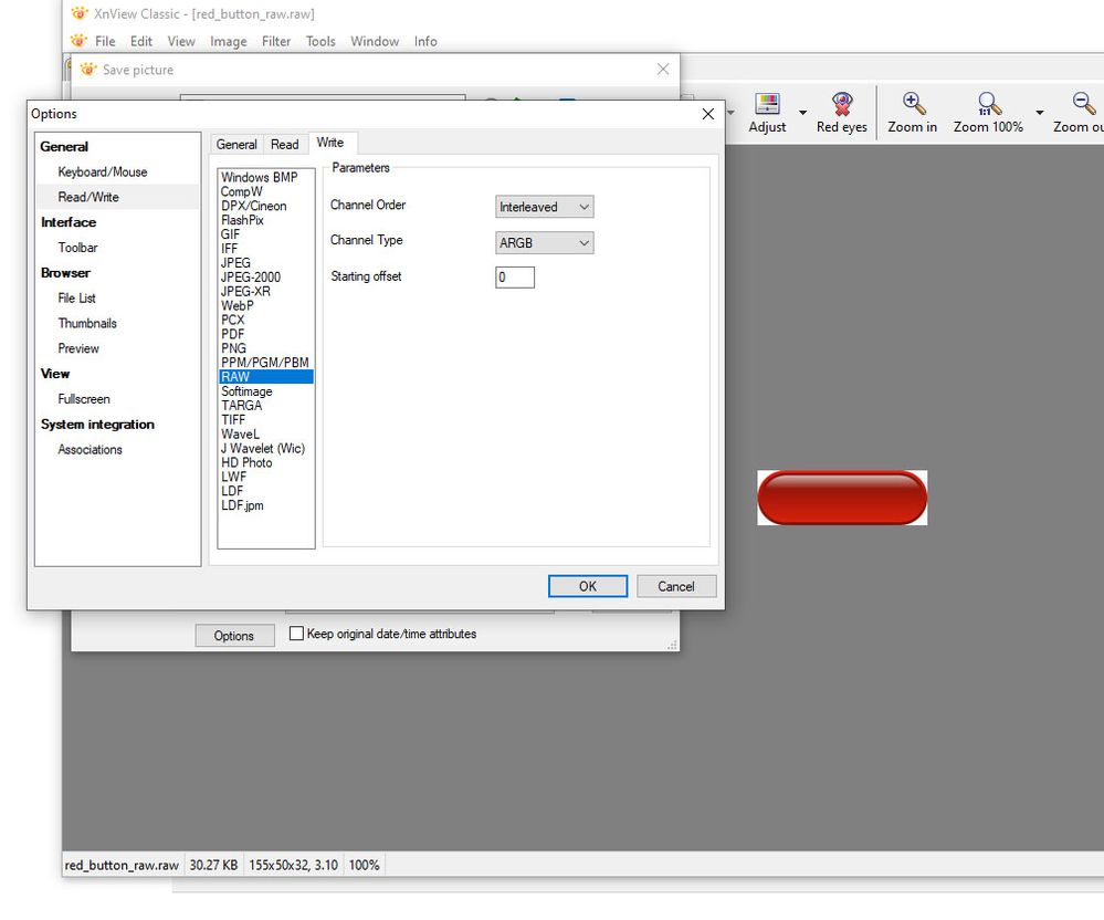

  • Menu: Image->32bits
  • Save as "RAW" format and before click "Save" you have to click "option" and set "ARGB".

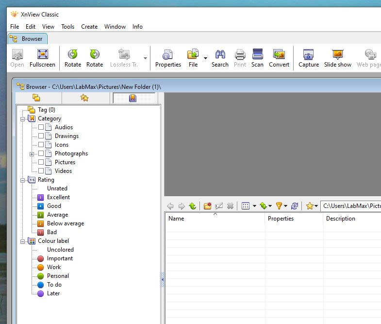

Mike_ST
Yes Xnview image viewer.
HxD: https://mh-nexus.de/en/hxd/
32 bits pixel mode should be activated as per following image, I set it to set 0xFF as default alpha value, or you'll get 0 as default, I think.
you must have older version this option is not available in 2.49.3, there is nothing in options, properties, view to add extra tool bar
Mike_ST
It is because you have not opened an image in the editor, you are showing the browser.
You have to click File=>Open and select a picture, or select one on the left in the browser.
The 32bits option appears only when a picture is opened.

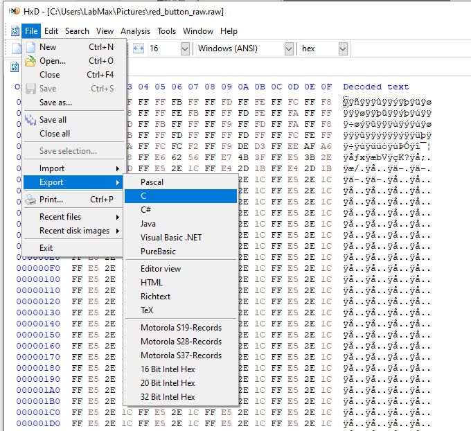

I did as instructed, I did the 32 bit image, then I open raw image in HxD export as C, and this is what i get
unsigned char rawData[31000] = {
   0xFF, 0xFF, 0xF1, 0xFF, 0xFF, 0xFF, 0xFB, 0xFF, 0xFF, 0xFD, 0xFF, 0xFE,
   0xFF, 0xFC, 0xFF, 0xF8, 0xFF, 0xFF, 0xFF, 0xF8, 0xFF, 0xFF, 0xFE, 0xFB,
   0xFF, 0xFF, 0xFD, 0xFE, 0xFF, 0xFA, 0xFF, 0xFF, 0xFF, 0xF7, 0xF8, 0xFD,
it does not look like the from ST. the ST looks like 32 bit

Mike_ST
Ok, HxD doesn't output 32 bits format text, only 8bits. I thought it could do that.
I suggest to write a small C program to open the raw file and output 32bits text,
and copy result in the array.
