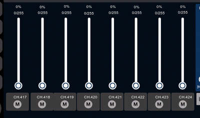

In my screen1 I use a “Swipecontainer”. I create 64 pages in the Swipecontainer and in each page I put my customcontainer. The problem is that when I create my 64 pages, my screen doesn't display anything (ESP32H7B3I-EVAL).
Do you know how I can solve this problem?
Best regards,

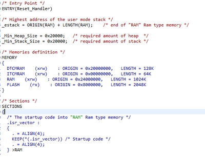

I think you meant STM32H7B3I-EVAL instead of "ESP32H7B3I-EVAL". Beside that, I highly suspect the memory size that is occupied by your screen that contains the Swipe Container. Having 64 pages filled with custom containers certainly takes a lot of space, probably larger than the allocated heap in the internal RAM.
I suggest either changing your application design so that you avoid having 64 pages in a single screen, or trying to increase the heap size, so the screen can fit in the memory.
2024-08-19 2:33 AM
I've increased the heap allocation

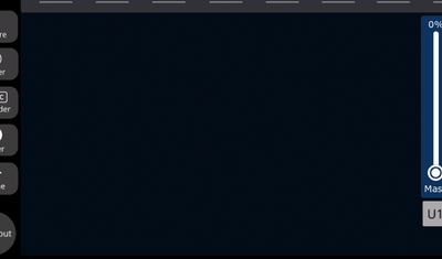

but it doesn't change anything. The container is displayed until page 53
but after that the swipe container page is empty.

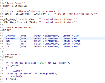

I tried to do the same thing for flash memory :

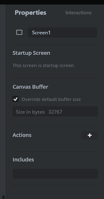

I also changed the buffer value for the screen :
Do you have any solutions, please?
