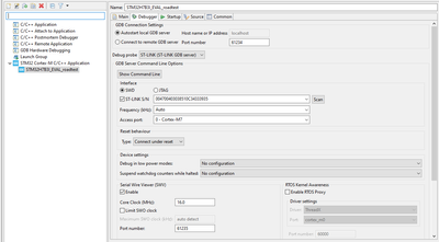

I'm currently learning how to use an STM32H7B3I-EVAL, I'm just starting out. I'm trying to debug a simple TouchGFX project with only a slider with STM32CubeIDE.

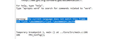

The problem is that when debugging I get a warning:
Warning: the current language does not match this frame.
set *(int *)0xE000EDFC=*(int *)0xE000EDFC|0x7F0I use : TouchGFX 4.20
CubeIDE 1.9
Does anyone have an explication please?
Solved! Go to Solution.

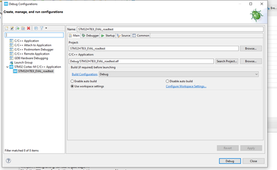

Hello @rozeelc,
I tried to replicate the project you have, but I didn't encounter the issue you mentioned.

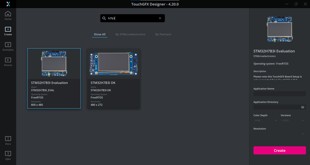

Are you using the available TouchGFX Board Setup (TBS) for STM32H7B3I-Eval?
TBS for STM32H7B3I-Eval

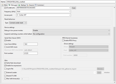

I also noticed that in your debugger, no External Loader is selected. Do you still manage to start the debugger?
2024-08-07 5:25 AM - edited 2024-08-07 5:27 AM
Hello @Mohammad MORADI ESFAHANIASL ,
I'm sorry for the inconvenience. I managed to resolve the initial problem by selecting an External Loader. However, I now have another question and I hope you can help me.

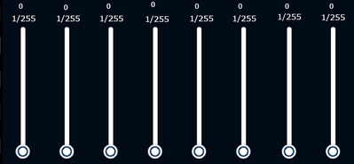

I am working on creating a mixing console with 512 sliders. I have created a page with 8 sliders, and it is necessary to swipe to switch from one set of sliders to another. Above each slider, I want to display its value. My problem is that to display the value of the slider, I have to create a new interaction for each one.
I would like to know if TouchGFX can handle more than 512 interactions and if there is a simpler way to achieve what I want.

To have a better architecture for your GUI, I suggest creating a Custom Container that contains the slider and a text area to show its value, then you can easily control the interactions inside the container.
Then, you can place your custom container instances inside a Swipe Container to accommodate all of them in a container that supports multiple pages.
