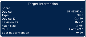

Device details
MPU: STM32H753AII6

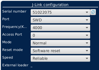

Connection:
Probe: J-Link V11.00 / SW version V7.98c
STM toolset: STM32 Cube Programmer / Trusted Package Creator v2.20.0

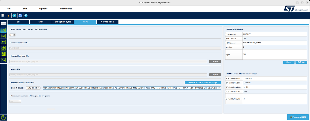

I also tried against the STM32H757I-EVAL board, which has a compatible CPU, with the same result.
HSM provisioning
HSM provisioningHSM provisioning
For Personalization Data I chose the group with the H753 in it, and from the 4 options in dropdown list the combination of "SFI" and Device ID "45002001" which is how the STM32H753 identifies.

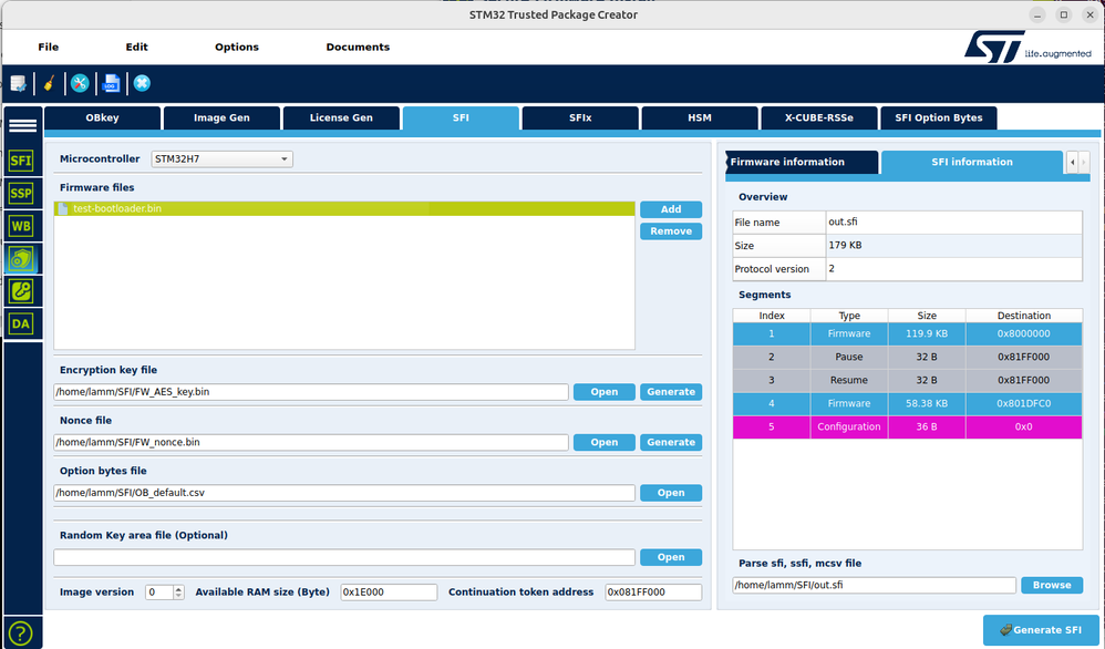

SFI creation
For the simplified example, there is only one section of code starting from default address 0x08000000.
Settings for RAM size and continuation token are default, and seem to make sense.
Option bytes are, except for RDP level = 0xBB (level 1), identical to the defaults after mass erase.
SFI creationSFI creation

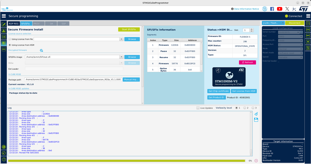

SFI flashing
SFI flashingSFI flashing
Complete log:

Jocelyn RICARD
Hello @theHolgi ,
The Segger driver attached to STM32CubeProgrammer does not have the capability to handle SFI properly as far as I know.
You can use either STLink or Segger Programmer.
Best regards
Jocelyn

 OK, I have a completely crazy idea: Use STMCubeProg v2.19 (which can use the HSM, but faild to build valid SFI packages) to program the SFI package created with v2.9 (which can create packages, but not use the HSM).
$ ~/toolz/STM32CubeProg19/bin/STM32_Programmer_CLI -c port=SWD reset=SWrst -sfi sfi_cube9.sfi hsm=1 slot=1
                        STM32CubeProgrammer v2.19.0
Succeed to get License for Firmware from HSM slot ID 1
Starting Firmware Install operation...
Activating security...
Warning: Option Byte: SECURITY, value: 0x1, was not modified.
Warning: Option Bytes are unchanged, Data won't be downloaded
Time elapsed during option Bytes configuration: 00:00:00.002
Activating security Success
Setting write mode to SFI
Warning: Option Byte: BCM7, value: 0x1, was not modified.
Warning: Option Byte: ST_RAM_SIZE, value: 0x3, was not modified.
Succeed to set write mode for SFI
Starting SFI part 1
Writing license to address 0x24020800
Writing Img header to address 0x24021000
Writing areas and areas wrapper...
RSS process started...
RSS command execution OK
RSS complete Value = 0x80
Reconnecting...
ST-LINK SN  : 003300163232511639353236
ST-LINK FW  : V3J15M7
Board       : STLINK-V3MINIE
Voltage     : 3,37V
Error: Unable to get core ID
Error: No STM32 target found! If your product embeds Debug Authentication, please perform a discovery using Debug Authentication
...retrying...
Voltage     : 3,31V
...retrying...
Voltage     : 3,35V
SWD freq    : 8000 KHz
Connect mode: Normal
Reset mode  : Software reset
Device ID   : 0x450
Revision ID : Rev V
Reconnected !
SECURITY State Success
Starting SFI part 2
all areas processed
Cheking security state after SFI...
Reconnecting...
Voltage     : 3,36V
...retrying...
Voltage     : 3,35V
...retrying...
Voltage     : 3,32V
...retrying...
Voltage     : 3,30V
...retrying...
Voltage     : 3,37V
...retrying...
Voltage     : 3,35V
Error: failed to reconnect after reset !
SFI Process Finished!
SFI file sfi_cube9.sfi Install Operation Success
