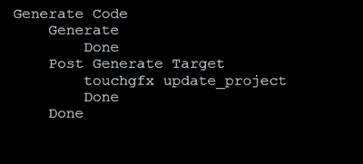

After changing the Typographies of my several font sizes from Calibri to Verdana and changing the contents of 2 texts to make sure, that texts need to be generated,  the only thing that happens is as follows:
- in the asset \ fonts folder the verdana.ttf is added
In the sub folder under "generated" for text and fonts:
- text source files are not created. Previous files are untouched
- font source files for the different typography are not created. Only the Calibri files still exist untouched.
The log is as follows (don't know where to find a file):
Then I deleted the complete folder "generated" and pressed "Generate code" again.
This should regenerate all sub-folders and files.
But the only subfolder in "generated" now are:
- gui_generated
- simulator
and a file named user.config
Missing folders:
- fonts
- texts
- images
- videos (which I actually don't use/need)
Please note:
I am not using the Simulator (this is not possible in the current configuration) and therefore I deleted the command calls in the Config-build setup for the simulator creation. Same applies for the Target, because the target is created with Keil separately. The TouchGFX application is running on a custom board with 2 processors, which are loaded separately via my own lootloader into system. The 2 processors have different tasks to aquire data from CAN busses, store data to SD card and flash, etc. The 2  STM32H7A3  communicate via internal SPI ports.
BR GS
