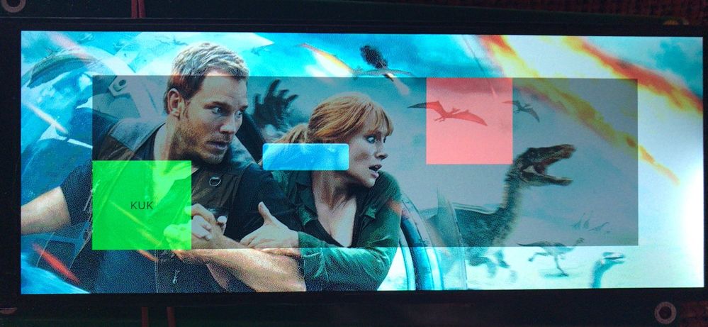

0693W00000AMRWmQAP.jpgPartial is usable only when LCD have own memory framebuffer. And too partial cant use acceleration. And one example of custom 1280x480 LTDC layer 0 image in flash, 1024x320 layer 1 320kB (internal ram) TouchGFX framebuffer with alpha 150.
