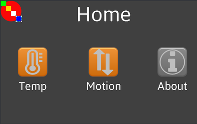

Hi all,
I'm trying to use the partial frame buffer feature and I get the first two partial frames (40 lines), but TouchGFX does not seem to update the screen into the partial buffer.  Just using TouchGFX no DMA, and no ChromArt.
My home screen is :
But the LCD only displays
Looking at the partial frame buffer, the rest of the screen is not rendered.
Do I need to make some call in frame transfer to update to the next partial frame?
Thanks

You need to implement a few functions, it is described in TouchGFXGeneratedHAL.cpp:
 * Functions required by Partial Frame Buffer Strategy
 *  int touchgfxDisplayDriverTransmitActive() must return whether or not data is currently being transmitted, over e.g. SPI.
 *  void touchgfxDisplayDriverTransmitBlock(const uint8_t* pixels, uint16_t x, uint16_t y, uint16_t w, uint16_t h) will be called
 *  when the framework wants to send a block. The user must then transfer the data represented by the arguments.
extern "C" int touchgfxDisplayDriverTransmitActive();
extern "C" int touchgfxDisplayDriverShouldTransferBlock(uint16_t bottom);
extern "C" void touchgfxDisplayDriverTransmitBlock(const uint8_t* pixels, uint16_t x, uint16_t y, uint16_t w, uint16_t h);
extern "C" void touchgfxSignalVSync(void);
touchgfxDisplayDriverShouldTransferBlock() should return the line number that it is safe to update the GRAM above to avoid tearing. This can be achieved using a timer. For examples of how these functions could be implemented, you can take inspiration from one of the provided Board Setups that use partial frame buffers. In general, that would be the ones for Nucleo kits with display boards attached.

Archer_Lawrence
The two buffers tah are displayed happen with in the taskEntry() routine.  The VSync()/LCD_Tear() routines are processed but do no draw any additional LCD buffers.
I've randomly tried many things.  Re-read the app notes multiple times without progress.
At this point I am out of time.  The project is stopped until I something new occurs.
I've been a big fan on STM, but  I am stuck.  I suppose I'll try another embedded graphic tool set.
Archer
Looking at this, there are a few things I am wondering about that you could check out if you get time and/or motivation.
First of all, is there anything that calls touchgfxSignalVSync() in your code?
You are expected to handle that yourself, preferably using an interrupt on a tearing effect output from the display, if available. Otherwise, a timer could be used, but that will probably result in tearing on the display.
Do you get calls to touchgfxDisplayDriverTransmitActive() and touchgfxDisplayDriverShouldTransferBlock()?
Archer_Lawrence
toughgfxSignalVSync() is being called in HAL_GPIO_EXTI_Callback().  This is part of the VSync IRQ routines.
touchgfxDisplayDriverTransmitActive() is called often.  Right now I have it hard coded to return 'false'.  I'll change that when I get DMA and the rest working.
touchgfxDisplayDriverShouldTransferBlock() is not called at all.
The system seems to draw 1 block into the PartialBuffer, then diplays it to the LCD().
Then it stays in a loop as follows...

I think I got it. You are not releasing the blocks after transfer. You need something like this, which you need to call manually when using blocking transfers, or from the DMA complete callback when using DMA
void DisplayDriver_TransferCompleteCallback()
    // After completed transmission start new transfer if blocks are ready.
    PartialFrameBufferManager::tryTransmitBlockFromIRQ();
Or, if you prefer, this:
    // Mark a block transferred
    FrameBufferAllocator* fba = HAL::getInstance()->getFrameBufferAllocator();
    fba->freeBlockAfterTransfer();
I tried your changes. got a little further but still stopped.
I'm looking into the touch IRQ.  It may be interrupting continuously. Which of course will cause all kinds of trouble.  I'll let you know what I find....
