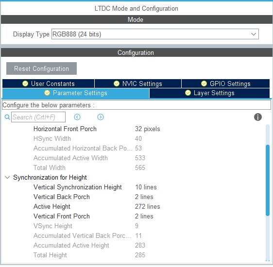

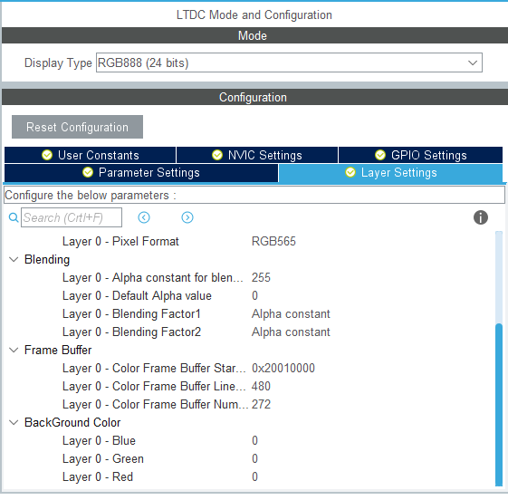

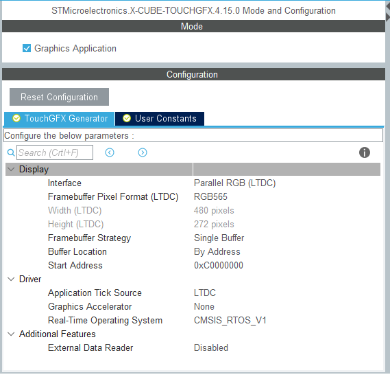

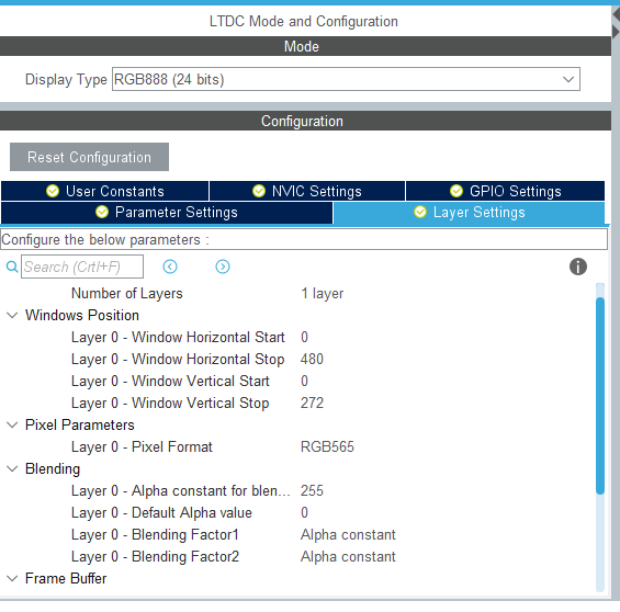

the .ioc cubeMX file is attached,
Im using f7 discovery witch uses 480*272 LCD so I need 480*272*16bit/8 = 261120 bytes space and stm32f746NG has got 320kbytes of internal RAM space, configuration is set on 1 framebuffer and the test gui is a simple background so i thaught it wont cause any problem to use this method but all i get is a black screen.
I'm e beginner maybe Im mistaken in storage calculation and I'm not considering something.
the cubeMx configuration screenshots are:0693W000005BoXvQAK.png0693W000005BoY5QAK.png0693W000005BoYAQA0.png0693W000005BoXqQAK.png

Out of curiosity, why do you put the start address at 0xC0000000 in the last screenshot? When I opened the ioc project you shared, it automatically sets it to 0x20020000. The configuration overall seems ok at first glance, I compared it to the F746G disco AT and the H7b3 disco AT we provide in Designer. The only thing that surprises me yeah is that you set the color frame buffer start address at 0x20010000 and then the start address for the "touchgfx" framebuffer at 0xc0000000
Could you test it real quick if that makes sense?
Romain DIELEMAN
November 18, 2020
In a normal STM32F746G disco board it is the SDRAM configured in FMC that is mapped at 0xC000000 . Are you using a custom hardware or you just modified the generated AT for the F746G disco?

Not now maybe later you need change ltdc window definition , but showed nothing is bad result. How you create your project?
When you test this on devkit board , good is start with real functional example and then change to internall ram .
MM..1
November 21, 2020
Or maybe any memory overflow addressing exist , then you change now 272 to 260 on ltdc_1 and 2 window config and too on touchgfx size automatic change

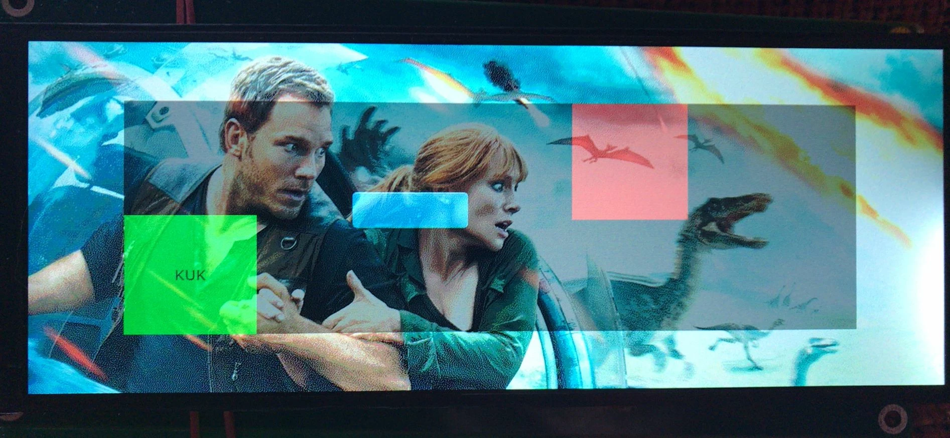

May 25, 2021
0693W00000AMRWmQAP.jpgPartial is usable only when LCD have own memory framebuffer. And too partial cant use acceleration. And one example of custom 1280x480 LTDC layer 0 image in flash, 1024x320 layer 1 320kB (internal ram) TouchGFX framebuffer with alpha 150.
