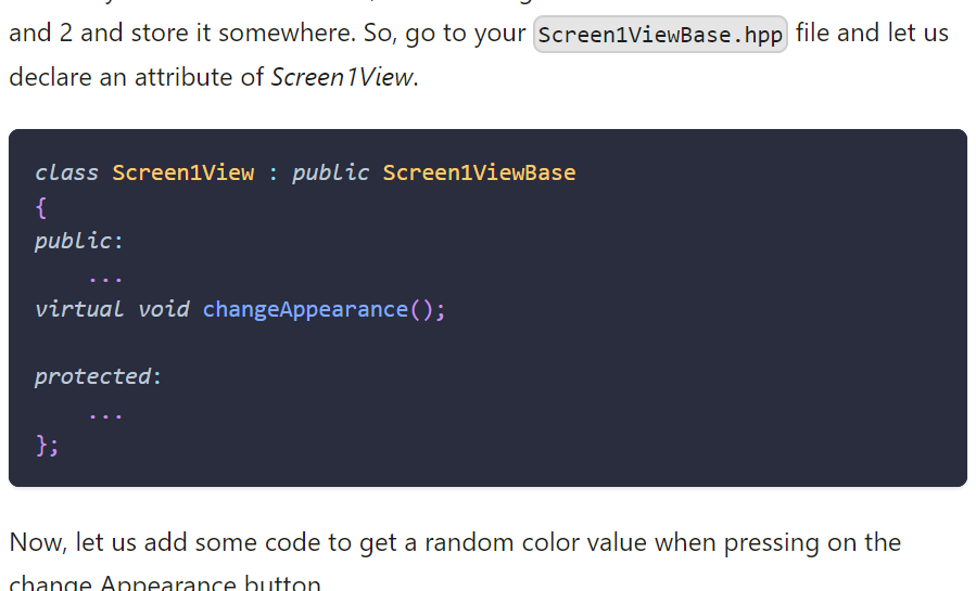

derek2399
How do I update screen using a wild card. ST docs suggest starting with this:
0693W00000Y9PjZQAV.pngThat file is write protected and does not appear to help. I guess using wild cards is easy.. but how?
