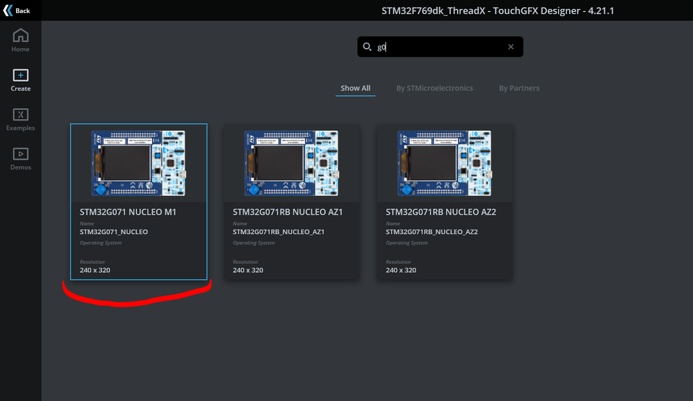

The documentation about lcd configuration in the project of G0+TouchGFX without using X-NUCLEO-GFX01Mx. THANKS !

Is it necessary to use the X-CUBE-DISPLAY package in CubeMX anyway?

It is not necessary to use the X-Cube-Display package. The TouchGFX Board Setup for the STM32G0 nucleo M1 available in TouchGFX Designer does not use it. You can have a look at it to understand the implementation. Concerning the documentation, have a look at the board bring up articles in the online documentation (available in Chinese as well). This other article will further help you configure spi displays on the G0 (if this is what you are going for).
