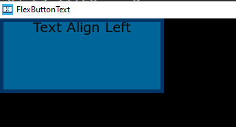

Hi @jchernus-fikst
Attached is an example showing how to change Flex Button text.
The implementaion in
\gui\src\screen1_screen\Screen1View.cpp
void Screen1View
::changeText () // override final
    auto circular_next_ttid = []() -> touchgfx::TypedTextId
        static std::array<touchgfx::TypedTextId, 3> ttIds
			T_BTN_FLEX_TEXT_ALIGN_CENTRE ,
			T_BTN_FLEX_TEXT_ALIGN_RIGHT  ,
			T_BTN_FLEX_TEXT_ALIGN_LEFT
        static std::size_t index = 0;
        int result = ttIds [ index ];
        index = (index + 1) % ttIds.size();
        return result;
	Unicode::snprintf
		flexButton1Buffer,
		FLEXBUTTON1_SIZE,
		"%s",
		TypedText ( circular_next_ttid () ).getText()
	flexButton1.invalidate ();
