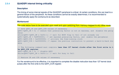

Could you please start with a simple example without TouchGFx. Try to switch from memory mapped mode to other mode. Please make attention for switching operation because there is an errata that must be respected if switching from memory mapped to any other mode using STM32H743 MCU for example.
For that please take a look at the MCU errata sheet  section QUADSPI.

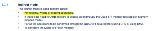

You can't Write, or send commands (ie WRITE ENABLE, WRITE PAGE, READ STATUS) whilst in Memory Mapped mode

For the QUADSPI interface, in memory-mapped mode, the external flash memory is seen as an internal memory but with some latency during accesses. Only read operations are allowed to the external flash memory in this mode.
For more information I advise you to take a look at Quad-SPI interface on STM32 microcontrollers and microprocessors - Application note
For the QUADSPI interface, the write operation is not supported in memory mapped mode.
For the OCTOSPI interface the write operation is supported in memory mapped mode as mentioned in Getting started with Octo-SPI, Hexadeca-SPI, and XSPI Interface on STM32 MCUs - Application note
Thank you.

2) Exit from memory mapped mode
QUADSPI-> CCR & =(~(QUADSPI_CCR_FMODE);
4) Using suggested workaround
5)  Reinitializzation
 HAL_QSPI_Abort(&hqspi);
  MX_QSPI_Init()
