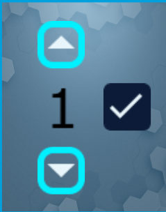

I am really new to TouchGFX and can't find a solution to my problem.
I want to increase or decrease a displayed value on my screen by clicking on a button.
I think I have to read the value each time by using getWildcard(). But now I have a data type conflict as I can't just handle it as an int and increase it. In the following you can see a picture of my screen.
Thank you in advance :)

if you using Text Area for increasing and decreasing the values.
1. Enable Wild Card buffer for your text area.
2. you have take one static variable ... based on UP & DOWN button you have to increase or decraese the value of static variable.
3. using  Unicode::snprintf(taBuffer, TA_SIZE, "%d ", variable); you can update value on screen.
4. after every update you need to call ta.invalidate();

Hello @Alx237 and welcome to the community!
You have to store your data as an int, increment or decrement that int and then display it.
Have a look at the TouchGFX Academy where we provide tutorials and video guides.
Please find attached an example of incrementing and decrementing value.
