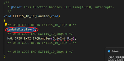

For example, when GPIO IRQ occur, it goes to EXTI15_10_IRQHandler().
UpdateDisplay() is called in it. This function is implemented by user, and used when updating minite string on LCD.
After UpdateDisplay() is called, it goese to Screen1ViewBase::updateMinuteString(). This function is generated by TouchGFX as an action. When it is called, update minute digit string.

You can achieve this easier by have a boolean volatile var as a flag.
In the file containing EXTI15_10_IRQHandler() :
extern boolean flagIRDisplay;
void EXTI15_10_IRQHandler(...)
flagIRDisplay = true;
and in your screen's code :
volatile boolean flagIRDisplay = false;
void handleTickEvent(...)
if (flagIRDisplay)
   updateMinute();
