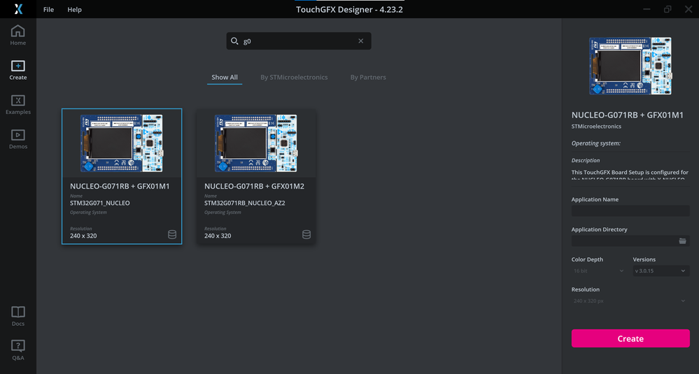

Unfortunately, there is no TouchGFX Board Setup available for the STM32F411, hence you need to start a new project from STM32CubeMX and proceed from there. There is a comprehensive tutorial in the TouchGFX Board bring up documentation that can assist you throughout this journey.
It is also worth mentioning that there are a few TouchGFX Board Setups that use SPI displays, which you can use as inspiration for your custom project. For instance, you can take a look at STM32 NUCLEO-G071RB or STM32 NUCLEO-WB55RG
STM32 NUCLEO-G071RB TouchGFX Board SetupSTM32 NUCLEO-G071RB TouchGFX Board Setup

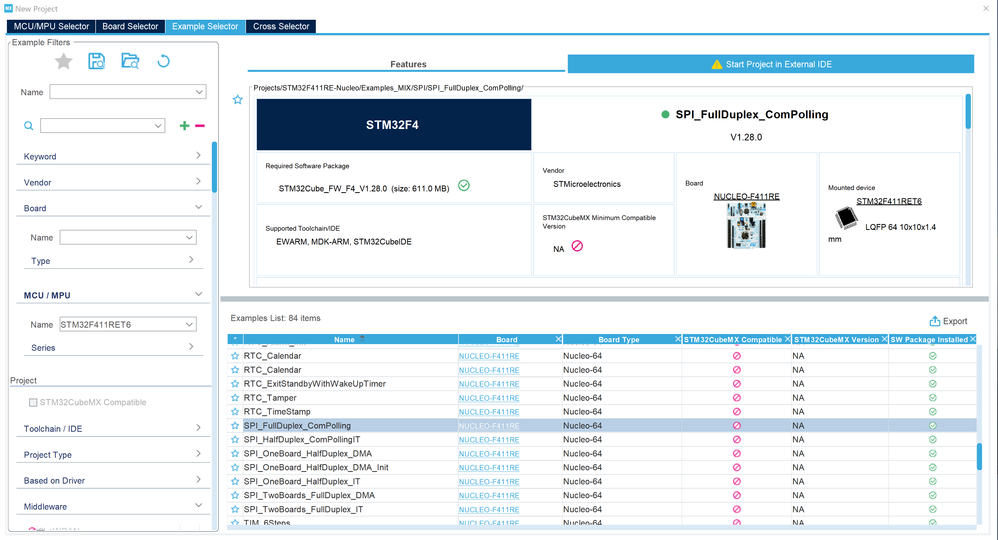

For sending data using SPI, you don't need to use TFT_LCD function. STM32CubeMX does contain some helper functions to send data easily.
Again, I suggest you to continue your process based on the available documentations, especially using this documentation .
There are also other examples in STM32CubeMX to demonstrate how to set up SPI communications. When you open STM32CubeMX,  select File -> New Project. Then, in the opened window, select Example Selector tab, under the MCU/MPU section enter the name of the MCU (STM32F411RET6) and the select a relevant example, for instance, SPI_FullDuplex_ComPolling. Then you will get the source code for how to set up the SPI configuration.
Example SelectorExample Selector
