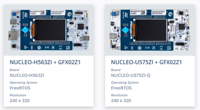

There are two TBSs available in TouchGFX Designer that use the X-NUCLEO-GFX02Z1: NUCLEO-H563ZI + GFX02Z1 and NUCLEO-U575ZI + GFX02Z1.
I don't know if you based your display initialization code on one of the TBSs? If not, you can find the initialization code in TouchGFXHAL.cpp within the TBSs.
