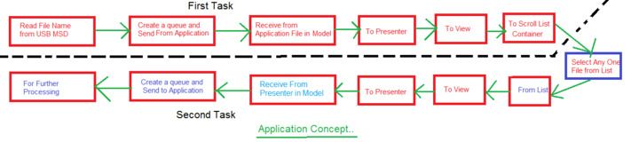

In my application, I have to copy File from USB Mass Storage to SDCard with TouchGFX GUI (Scroll List) with Add/remove feature .
USB Mass Storage and SDCard with FATFS + exFAT works well without TouchGFX .
How to I transfer "File Names" from USB Mass Storage to TouchGFX GUI scroll list?
So for simplicity, I have created array in main.c then try to transfer to GUI Scroll List Items.
But so far there is no example I have seen on touchgfx website, Is this the prefect/right method of not ?
I have written some steps as attachment .
Please advice how to proceed this ..
Thank in advance ..
Karan

Sorry... I couldn't find suitable tutorial to fulfill my task .Please guide me as below:
I want to propagate data (Array -2D) File Name in my case :
From
Application data (File Names) -> Model -> Presenter -> view -> Scroll List Items(Custom Container)
and
Scroll List Item -Select any one) (Custom Container) -> view -> Presenter -> Model -> Application
For further processing..
Karan

Wouldn't it be smarter to pass a structure pointer that encapsulates the complete content, and size/length/count information?
What's the point of sending single items with no delimiting?
Allocate a buffer to hold the queue content, fill that, pass the pointer as a queued message, and at the far end cast the unqueued message to a pointer, extract the content, and deallocate the buffer.
If you must send a list of ASCIIZ messages in an array, send a pointer the whole array, with some NUL termination at the end so you can scope the content.
The benefit of allocating a buffer (could be a small pool), rather than using a static one, is that you don't have to worry about the content changing in-flight, or managing the ownership or reception once you've queued it.

Perhaps you have a programmer on your team? I think you need to confer with the lead on the project if you don't understand things. You can't expect ST staff to carry basic programming tasks/objectives.
No, not really. I don't understand why you have to pass multiple individual elements in the queue to simply unpack them on the other side. It is like talking a bus to a destination, and halfway along you make people get off the bus, cross the street, and get into a second bus, for little/no reason, when the first bus could have taken you all the way, with less effort.
  1. char TxBuffer[]=
  2. {
  3. "BANSAL.bmp\0" , "HELLO.png\0" ,
  4. "TouchGFX.txt\0" , "STM32F7.doc\0" ,
  5. "SCROLL.bmp\0" , "NEW.xlsx\0" ,
  6. "LIST2.jpg\0" , "GOOD.bmp\0" ,
  7. "ABC.png\0" , "XYZ.bmp\0",
  8. NULL
  9. } ;
xQueueSend(messageQ_USB ,(uint32_t)TxBuffer,(TickType_t)100 ); // Send once as a blob
Where the "handle / instance" is a pointer to some self-contained object. Personally I'd prefer the structure/object form that Martin suggested, but you keep coming back to this array.
Then enumerate through the list, filling the Scroll List with items until you encounter the NULL marking the end of the list, for cases where you've got more/less than 5 items
