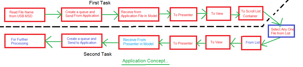

I mean to say that how to propagate data (Array -2D) File Name in my case :
From
Application data (File Names) -> Model -> Presenter -> view -> Scroll List Items(Custom Container)
and
Scroll List Item -Select any one) (Custom Container) -> view -> Presenter -> Model -> Application
For further processing..

I am seeking example program or How I can do
To propagate data (Array -2D) File Name in from Application data (File Names) -> Model -> Presenter -> view -> Scroll List Items(Custom Container).
and Scroll List Item -Select any one) (Custom Container) -> view -> Presenter -> Model -> Application
