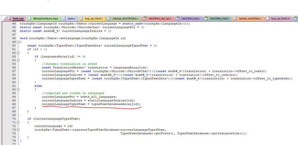

Hi,PJEN
I'm using STM32F429 to put touchgfx image resources in external unmapped serial flash, debugging found into Hardfault, I also refer to the official <Caching Bitmaps> and <Using Non-Memory Mapped Flash for storing images>, also just started to use touchgfx, hope you can describe what modifications to make to put touchgfx image resources in external unmapped serial flash.
Execute the code as follows to the red line 66, and you will enter hardfault:
skullboyer
June 1, 2020
I put the following xx_Section in external serial flash by loading the algorithm
Modify the blockCopy() interface with reference to the official documentation as follows
I don't know what else I need to change, looking forward to your guidance, thanks!
PJENAuthor
June 1, 2020
Hi Skullboyer
I followed the same rules given in the documentation for the same results ;-).
I'm waiting for a solution from ST as it seems to be an issue in the TouchGfx library.
A patch should come soon ....
skullboyer
June 2, 2020
Oh�?You mean the methods presented according to the official documentation won't work?
PJENAuthor
June 2, 2020
The method from documentation is working with non indexed image formats (those that do not rely on CLUT's).
If you want to use indexed color images, you have to keep the 'extra' section in internal flash so the library can address the clut with a pointer.
Do this in the TouchGfx designer in the 'image' setup screen like in this screen shot, and map the ExtFlashSection only in the external (non memory mapped) flash.
Keep the IntFlashSection in the internal cpu flash.
0693W000001ppS2QAI.pngTo have this working, 'extra section' must be kept in 'IntFlashSection' because this section will be addressed with a pointer in the library !!!
And also, in your linker file, I see you placed 'FontFlashSection' and 'TextFlashSection' in your external memory ... not sure that it is working !!
I've seen in the documentation that the fonts may also be placed in a non memory mapped external flash, but never tried it.
Maybe you could try to place those Font and Text sections in the CPU flash memory (if it's not too big) , so only the images (ExtFlashSection) will go in your external flash
