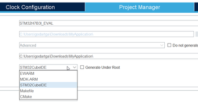

Hello @sheng yang ,
I have checked the project you shared as a zip file.
You say that you try to build using MDK542a.
To build and flash using Keil, in STM32CubeMX => Project manager => Toolchain, you have to change the toolchain and IDE:
Then you have to generate code using STM32CubeMX with set MDK-ARM.
Then you have to go back to TouchGFX Designer and generate code there aswell.
Then you can go to your Keil IDE and build and flash.
If you struggle to flash, you can flash the bin using STM32CubeProgrammer.
Regards,
Gaetan Godart
Software engineer at ST (TouchGFX)

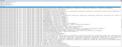

after I regenerate the mdk-arm project, I get new errors as below:
Hello @sheng yang ,
It looks like your linker is not aware of the TouchGFX framework (library).
Can you check that you have the TouchGFX framework in your project's libraries?
Can you tell me the steps you did to create your project?
Regards,
Gaetan Godart

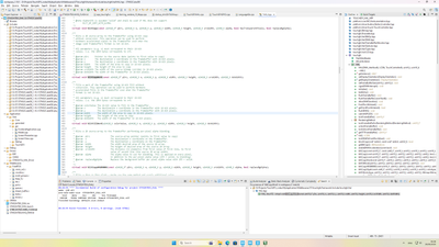

Besides I regenerate the project with stm32 cube IDE, it can compiled success as

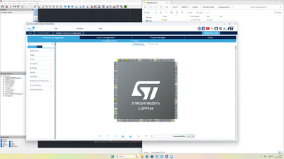

I have a board with stm32H7B0ZBT6, and I want to use touchgfx with my board. Now I use touchgfx designer generate a STM32H7B3I_EVAL demo, I try to just use stm32cubemx open STM32H7B3I_EVAL.ioc and change the chip and releate settings then regenerate the files. But after I rechange the chip , I found stm32cube mx recreate a new project.
I wonder is there any way that I can run touchgfx simple demo on my stm32h7bzbt6 board ?
Besides I append a stm32cubeide project of myboard, I have an  another question how could I regenerate the touchgfx code to this project ?
