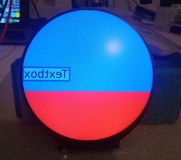

I am working with a custom board I designed using this display(LINK) They provide init codes on the product page that I have integrated into my project but they do not provide any any porch, timing or polarity information. I first setup LTDC and the DSI host and was able to display a solid color on the display by generating a frame buffer in code and setting each pixel. I then moved on to integrating touchGFX and was also able to get that working fairly easily but the display is mirrored on the x-axis as shown here:

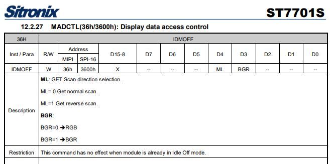

The display is using a ST7701s controller, I found the MADCTL register in the datasheet that I believe should be able to mirror the display but I am not getting the expected output.
Here is how I am writing to this register
HAL_DSI_ShortWrite(&hdsi, 0, DSI_DCS_SHORT_PKT_WRITE_P1, 0x36, 0x10);

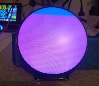

And this is the output after doing so
I have verified the ability to write to this register by setting the "BGR" bit to a 1 and the display will swap the red and blue channels, I am not sure where to even start with troubleshooting this issue.

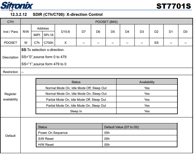

The init code sets the SS bit in SDIR. This will flip on the X direction. Remove that code, and you should be fine.
2024-10-20 11:24 AM
Check if you can fix on the STM32 side, and how it renders the frame buffer.
Or the top/bottom is not well defined, controller supports 480x864, not 480x480
ie LNESET = (480 / 8) - 1
ML is used to flip vertically

I have also tried to change the SDIR (0xC7) register to SS=”1” source form 479 to 0, that makes no visible difference.

2024-11-05 4:20 AM

2025-07-19 5:01 AM - edited 2025-07-19 5:03 AM
For SDIR to work you first need to enable Command2 BK0. It should look like that:
const char CND2BKxSEL = 0xFF;
const char SDIR = 0xC7;
char sdir = 0x04; // Mirror X on
const char CN2BK0SEL[] = {0x77, 0x01, 0x00, 0x00, 0x10};
const char CN2BKxDIS[] = {0x77, 0x01, 0x00, 0x00, 0x00};
// Enable BK0
command(CND2BKxSEL, sizeof(CN2BK0SEL), CN2BK0SEL);
// Apply SDIR
command(SDIR, 1, &sdir);
// Disable all command banks
command(CND2BKxSEL, sizeof(CN2BKxDIS), CN2BKxDIS);
