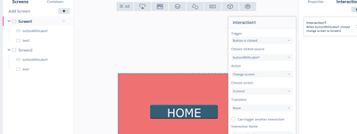

currently working on touchGFX(without RTOS)+stm32h723zgt6+ltdc display .
First Screen1 is coming  with touchGFX  but touch x,y coordinates not changing the screen2.
touchGFX screen1 interaction made as follows .
i do not attached any touch sensor ! instead of touch sensor i made manual touch x ,y coordinates input by following code . due to manual matrix key button for future use .

main.c
volatile uint32_t tempx=0;  //// declared in glopal
volatile uint32_t tempy=0;  //// declared in glopal
volatile uint32_t gate=0;  //// declared in glopal
 MX_TouchGFX_Process();
    /* USER CODE BEGIN 3 */
  if(gate==1){tempx=234; tempy=136; gate=0;  }
  if(gate==2){tempx=0; tempy=0; gate=0;}
i am trying to give x, y coordinates  manually but no screen change .
