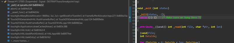

During operation, this leads to a deadlock of TouchGFX after a few minutes. TouchGFX gets stuck in the function “getBlockForTransfer(Rect& rect)” in the line “assert(state[sendingBlock] == DRAWN);” (File: FrameBufferAllocator.hpp).
After that, the display is no longer updated.

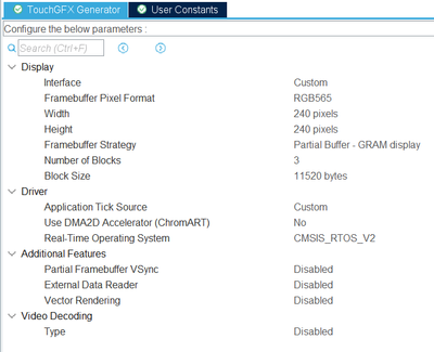

Attached is the configuration.

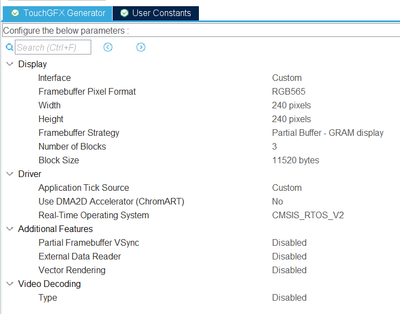

You find attached an image of my settings. Do I need to adjust anything else?
Just as a reminder, I don't have a TE pin (the display doesn't have one) and vSync is generated by a FreeRTOS timer.

You need to set the "Partial Framebuffer VSync" to enabled, to to have this weak function generated and called by the framework.
To elaborate what I wrote earlier: If you do not have a TE signal or any other feedback from the display about where it is in its drawing cycle, you will most likely always risk to have tearing in your GUI. And in this case, I am sure I see the point in implementing "waitUntilCanTransferBlock", if you do not know when it is "safe" to transfer.
