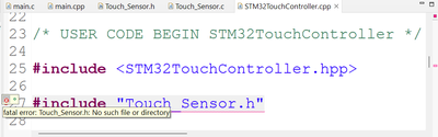

hi,
i am trying to attach a Touch Sensor header file  with touchGFX STM32TouchController.cpp file but it's showing error .
the Touch_Sensor.h & Touch_Sensor.c file are include project file and further included via path location ( Properties ->General -> path.).

hi,
(Touch_Sensor.h & Touch_Sensor.c) file  path location add must be  with GNC C++ too will eliminate the issue .
earlier i have  made(Touch_Sensor.h & Touch_Sensor.c) file  path location  only with GNC C  .

Does the project build okay? If the compiler can't find it, you're probably missing something. Show your include settings and show the location of the file.

hi,
