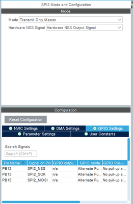

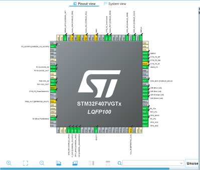

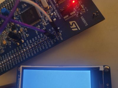

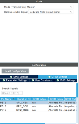

I want to use ILID9341 screen on STM32F407G-DISC1 without any libraries, just spi protocol. However, while the screen turns on, I can't draw anything on it. Why is this the case?
This is SPI configuration.

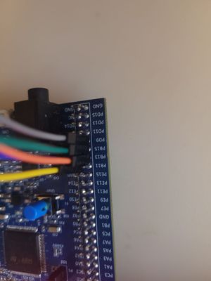

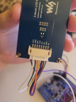

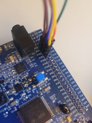

I have checked the physical wiring, and it seems to be correct.

}I think that my initialization function may be not complete, but I don't know how to complete it.

@cockatoo wrote:I have checked the physical wiring, and it seems to be correct.
Please post the schematic so that others can check & confirm.
Also a good, clear photo can help.
Have you checked carefully that the connections you use are not "obstructed" by other features on the board?
Have you established that the basic SPI comms is working?
@cockatoo wrote:there is also a code for functions for reading values from accelometer, which is probably not relevant
It would be best to remove it - concentrate on just one problem at a time; minimise the number of unknowns.

Have you confirmed that the screen works on a known-good system; eg, Arduino ?

2025-12-02 2:49 AM
@cockatoo wrote:Basic SPI communication does work, because the following snippet visibly resets the screen.
But that snippet does not use SPI at all !
It's purely asserting the hardware reset line.
So that tells you absolutely nothing about the operation of the SPI !
2025-12-02 2:57 AM
I have commented out the main() code for non-screen functionality, however, it still does not work.
2025-12-02 3:01 AM - edited 2025-12-02 3:05 AM
Have you verified the basic SPI operation yet ?
Without basic SPI comms, nothing is ever going to work.
PS:
Edited as you have a write-only SPI, so can't read anything
2025-12-02 3:32 AM
How do I check if it works?
