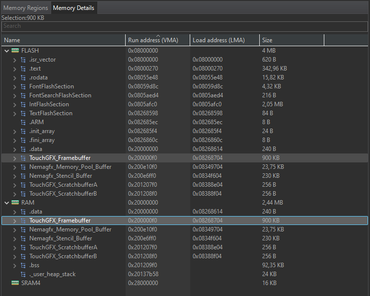

Hi. While testing the animation, I noticed strange behavior in the Animated Image widget when using the RGB565 image format with compression.
I'm using an STM32U599, LTDC/RGB24bit, the animation is started with a button.
Immediately after startup, the widget area turns white with dots. I could understand this if it were some kind of limitation resulting from the compression. But...
If the widget is placed in a Swipe Container widget, after changing the screen and returning, the white area disappears, and the animation executes correctly. What could be the cause? I'm concerned about compression, because in this case, the size difference is tenfold.
I also want to know if there's an option somewhere to prevent the framebuffer from being placed in flash memory every time the project is generated? Currently, I add the "__attribute__ ((section (".noinit")));" parameter, but this has to be done every time the configuration changes...

Hello @Jin454 , ok so this is the issue. CubeIDE indeed generates a linker script but it's uncomplete. When you use TouchGFX you have to add the framebuffer section that I mentioned in my previous message :
@Osman SOYKURT  wrote:
Hello @Jin454 ,
Could you double check if you have correctly activated image compression feature in TouchGFX Designer? We have this article that might help.
For your second question, framebuffers are supposed to be placed in RAM memory and not in flash since you have to write its content whenever a change on screen happens. In all our examples, you could see we're storing the framebuffer in RAM. For instance, this is what we have in the linker file for our STM32U5A9J-DK TBS :
  FramebufferSection (NOLOAD) :
    *(TouchGFX_Framebuffer TouchGFX_Framebuffer.*)
    *(.gnu.linkonce.r.*)
    . = ALIGN(0x4);
  } >RAM
You can check one of our TBS's linker script (for instance the STM32U5A9J-DK TBS , the linker is called STM32U5A9NJHXQ_FLASH.ld) if you need an example.

Thanks for the reply.
Regarding the compression problem, I found the cause.When using compression, the image format must be identical to the framebuffer format. I was using an RGB888 framebuffer, but the image was in RGB565 format. The problem only occurred when compression was enabled. Maybe this information will be useful to someone.
Regarding the framebuffer location problem, after generating the project in the Stm32CubeIDE, it generates the TouchGFXGeneratedHAL.cpp file with the code:
namespace
// Use the section "TouchGFX_Framebuffer" in the linker script to specify the placement of the buffer
LOCATION_PRAGMA_NOLOAD("TouchGFX_Framebuffer")
uint32_t frameBuf[(480 * 480 * 2 + 3) / 4 * 2] LOCATION_ATTRIBUTE_NOLOAD("TouchGFX_Framebuffer");
static uint16_t lcd_int_active_line;
static uint16_t lcd_int_porch_line;
This causes the framebuffer to be placed in both RAM and flash, as shown in the attached image. The problem definitely occurs on the Stm32U5 and Stm32H5. I haven't tested the others.
After each code generation, you need to change the code to:
namespace
uint32_t frameBuf[(480 * 480 * 2 + 3) / 4 * 2] __attribute__ ((section (".noinit")));
ScratchbufferA and B shouldn't be only in RAM either?
LOCATION_PRAGMA_NOLOAD("Nemagfx_Memory_Pool_Buffer")
static uint8_t nemagfx_pool_mem[NEMAGFX_MEM_POOL_SIZE] LOCATION_ATTRIBUTE_NOLOAD("Nemagfx_Memory_Pool_Buffer"); /* NemaGFX memory pool */
LOCATION_PRAGMA_NOLOAD("Nemagfx_Stencil_Buffer")
static uint8_t nemagfx_stencil_buffer_mem[NEMAGFX_STENCIL_POOL_SIZE] LOCATION_ATTRIBUTE_NOLOAD("Nemagfx_Stencil_Buffer"); /* NemaGFX stencil buffer memory */

Osman SOYKURT
Hello @Jin454 ,
    . = ALIGN(0x4);
  } >RAM
Osman SOYKURT
Jin454
Adding all buffers to the appropriate section solved the problem. Regenerating the project doesn't remove it.
Thanks for your help.
