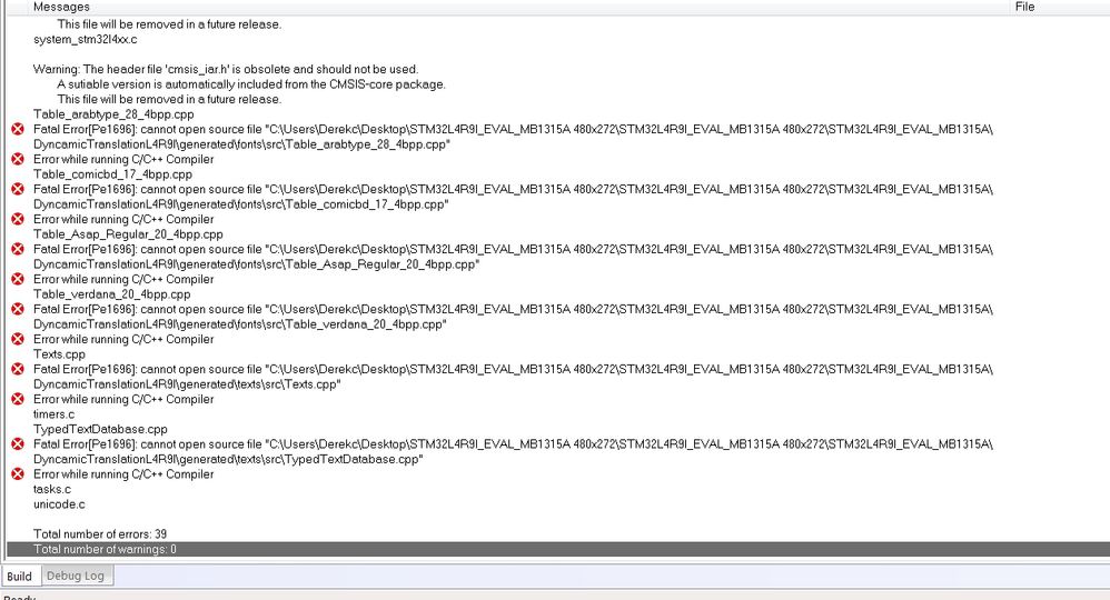

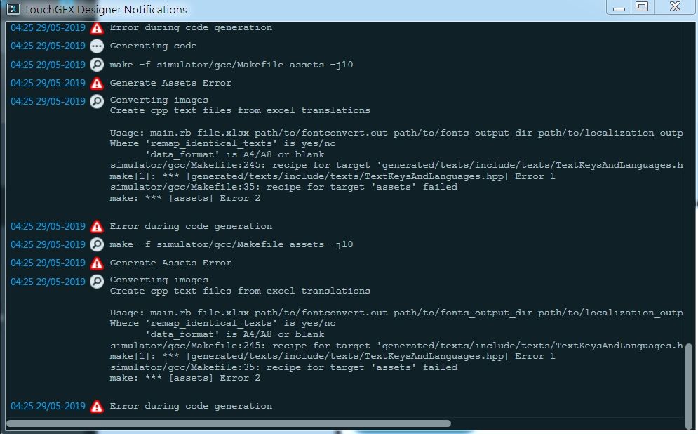

0690X000008a7XBQAY.jpg0690X000008a7XGQAY.jpgHi Martin,
We load this project in TouchGFX designer 4.10.0. It shows errors when doing code generation. We compile this project. It shows some files is missing. Could you help ? Thanks.
The first screenshot definitely says that you have no generated files (by designer) to compile. They cannot be found. The second confirms that code generation failed. I may need to see your project.
Hi Martin,
The code generation failure causes the file missing in compilation. Please check attached project file after code generation. Thanks.
Hi Martin,
You said that this project is based on not-yet-released version of TouchGFX. I guess that's why file is missing. Could we work around by just offering me the missed files ?

Please look further up this post for a project. It's mostly for inspiration on initializing the LCD since the project is based on a version that isn't released yet. But take a look and let me know!
/Martin
