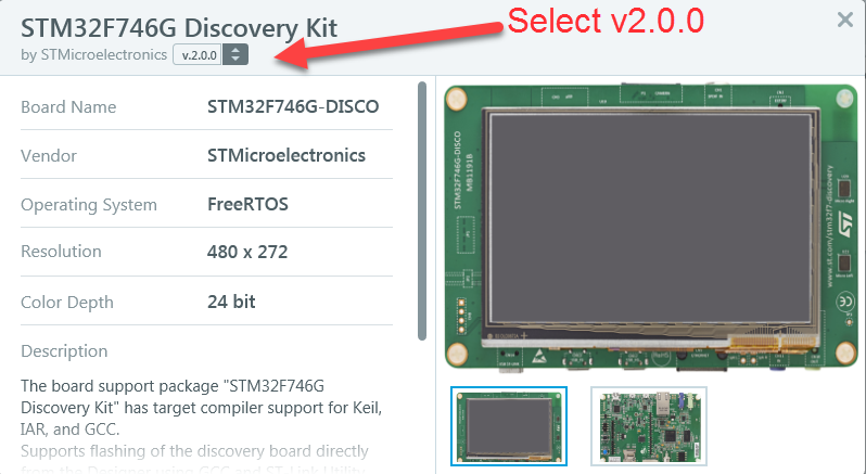

Hi. Maybe this will help,
a) launch the TouchGFX 4.10.0 tool as a stand alone
b) select the F746G-Discovery target
c) Select the v2.0.0 template
d) proceed to create some simple gui -> Generate code -> test with simulator
e) if the above works, review the source code -> lower right corner of the TouchGFX tool will allow for the viewing of the generated code folders
You should be able to view the TouchGFX v2.0.0 generated template here. It is in ASCII format.
Hope this helps.
