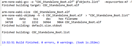

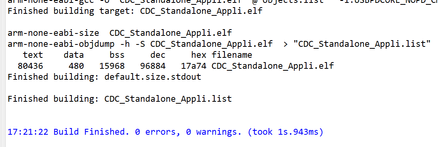

> CDC_Standalone
> Nucleo-H7S3L8 board
If I try this example via the Example Selector in STM32CubeMX, it generates the project and compiles just fine (both boot and application). Make sure you change the toolchain to STM32CubeIDE. Click "Generate Code" then "open project" when it completes.
Maybe try loading the project that way. Toss the tutorial.
