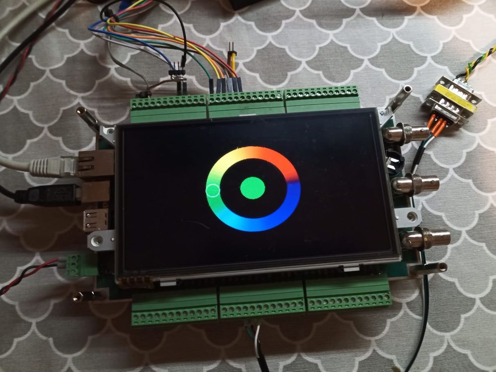

Hello Gaetan,
thanks for sharing this widget, it works quite cool :smiling_face_with_smiling_eyes:
I thought about something similar, yet using a predefined palette.  The idea was loading it from a CLUT table (out of L8_xxx bitmap) or define it directly as an array of RGB colors.
LTone board running ColorPicker widgetLTone board running ColorPicker widget

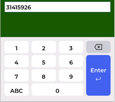

The number keyboard and the demo show how to use it.

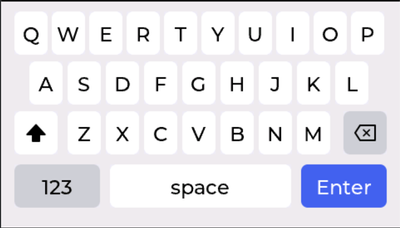

alphabetical keyboard

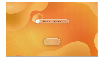

Please find attached a new custom widget (tpkg file and example of usage).
It is a confirmation/validation slider, the type you have on payment services.
I hope you like it! :smiling_face_with_smiling_eyes:
To see how I created the widget and how to use it watch this video !
