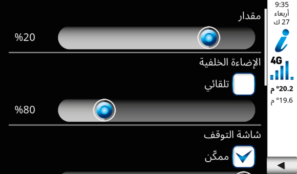

I'm not sharing a new widget, but rather an extension.
It is a Slider with the added feature of reversing direction. Usage is pretty straightforward.
It may be used e.g. for RTL layouts.
Alessandro

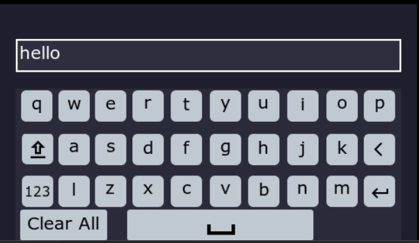

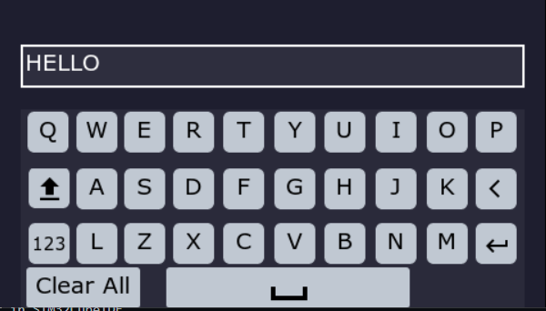

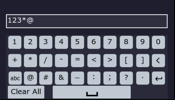

DhruvDave46
The complete project, along with the reusable custom keyboard container, is available on GitHub.
I have also included the .tpkg file in ZIP format for easy access and installation, attached below.
GitHub Link:https://github.com/dhruvdave4/touchgfx_advanced_keyboard
