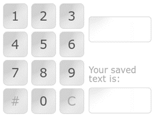

Juliette CRESPO
September 28, 2022
Here is a zip file containing a guide and the keyboard custom container in the .tpkg format.
0693W00000UFIplQAH.png/Juliette
April 17, 2025
Hello @Juliette CRESPO ,
Thanks for sharing the keypad/board widget,
Could you please let me know what steps should I follow or how shall I use it touchgfx application?
I mean I need to get the typed names (from keyboard) into username and password textarea. I have imported the .tpkg file, able to add the widget into screen and now what next to do to get the typed data into Username and Password for authentication.

GaetanGodart
April 23, 2025
Hello @ShivDesh ,
This thread is mostly to share custom widgets, not to ask questions otherwise it will get spammed very fast. :)
If you want to have an answer, I suggest you to create a new thread with details of what you want to do and with a reference to the custom container you want to use.
To give you a quick answer, the keyboard have a function called getText in the Keyboard.cpp that returns the buffer storing the data, so it seems you should call that function and write the returned value into your desired textArea.
If this answer is not enough, please create a new thread.

Juliette CRESPO
October 3, 2022
Here is a zip file containing a keypad in .tpkg format and its guide.0693W00000UnEH9QAN.png
August 9, 2024
I'm trying to use your keypad. In my screen I added the keypad container. The circles 1, 2, 3 ... will be buttons.
If I select button 3 for example, I would like the value of savedTextArea to appear in the screen above button 3 and not in the keypad container. It would also be necessary for it to become a variable linked to button 3 that I could later save on an eeprom. Same for each button.
I tried several things but I can't do it. Could someone give me an idea, a piece of code to move forward?
August 13, 2024
up please

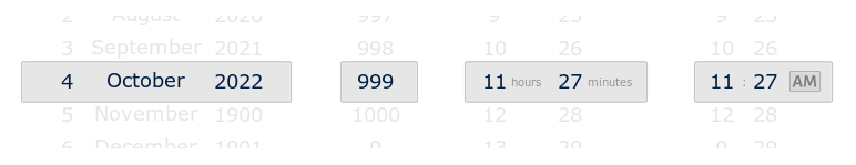

Juliette CRESPO
October 4, 2022
Here are different selectors: one for the date, one for the numbers and two for the time. This zip file contains the selectors in .tpkg format and a guide.0693W00000UnIpFQAV.png

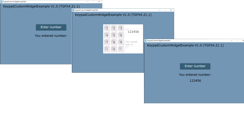

Roger.ch
February 23, 2023
Hello Juliette.
Thank you for your keypad widget.
I have integrated it into a separate container.
Do you have any idea how I call a function of the parent container after the poundFlexButton is depressed?
Sequence:
The keypad is invisible.
When I press a button in my container the keypad becomes visible. Works.
When a string is entered the keypad becomes invisible again when the poundFlexButton is pressed. This works.
Now the parent container should realize that it can call the function Keypad::getText and take the text?
Can you give me a tip?
Best regards, Roger
Graduate II
February 25, 2023
Hi Roger. Here is simple example how to get callback from keypad after pound is pressed.
Roger.ch
February 25, 2023
Hi JTP
Thanks a lot for your help.
Exactly what I was looking for.
You are saving my weekend right now.:grinning_face:
Have a nice weekend.
Best regards,
Roger
Graduate II
October 26, 2023
Hello
Yes, add these function definitions to DatePICKER.hpp under public items:
void setDay(int16_t day) // day 1-31
	if(day>=1&&day<=31)
		numberDateScrollWheel.animateToItem(day-1, 0); // 0= first day in wheel so decrease 1
void setYear(int16_t year) // year 1900 -
	if(year>=1900&&year<(yearScrollWheel.getNumberOfItems()+1900))
	 yearScrollWheel.animateToItem( year-1900, 0); // 1900 is first in wheel so decrease 1900
void setMonth(int16_t month) // month 1-12
	if(month>=1&&month<=12)
		monthScrollWheel.animateToItem(month-1, 0); // 0= january in wheel so decrease 1
It should do pretty much what you need :D
You can also add number of items of yearScrollWhell to get current year + some extra availabe
Br. JTP
