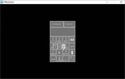

GaetanGodart
March 15, 2024
Please find attached a new custom widget (tpkg file and pdf instructions).
It a T9 keyboard. the old style of keyboards used on phones (not smartphones).
It is more compact and therefore it is suitable for small screen projects.
Regards,
Gaetan GodartSoftware engineer at ST (TouchGFX)
Graduate II
March 21, 2024
Hello Gaetan
Nice work !
Perhaps cursor (just static vertical bar '|'.. or even blinking) would be useful addition. Now when press space, you cannot see that in the text area.
Br JTP

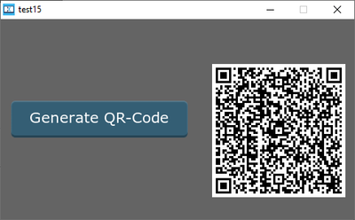

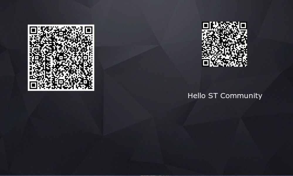

Hello wonderful community,
I'm glad to share a custom QR Code widget with you that you can use to create a QR Code either from text provided in the code or text from a Text Area in the designer.
It is worth mentioning that the size of the QR Code symbol depends on the version you choose (from 1 to 40, you can read more about the different sizes here ) and the scale (i.e. multiply factor).
QRCode widgetQRCode widget

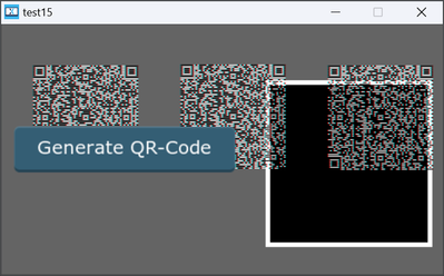

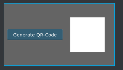

Can you please give an example or documentation? I imported your widget in an empty project and I put in a single container in a screen (also added a button and a background). I get 3 QR codes in the background. I did not write a single line of code, this is the default behavior of your widget.
"Kudo posts if you have the same problem and kudo replies if the solution works.Click ""Accept as Solution"" if a reply solved your problem. If no solution was posted please answer with your own."
Graduate II
April 4, 2024
Hello array
Seems that your project is having 24 bit colors and as default, this widget uses 16 bit color.
So browse to the \test15\TouchGFX\gui\include\gui\widgets\ folder and open 'QRCodeWidget.hpp' file. There comment 16 bit define and uncomment 24bit define. Like this
//Uncomment based on the selected display bpp (Bit per Pixel)
//#define QR_WIDGET_USE_8BIT_COLOR 1
//#define QR_WIDGET_USE_16BIT_COLOR 1
#define QR_WIDGET_USE_24BIT_COLOR 1
then it works:
Hope this helps.

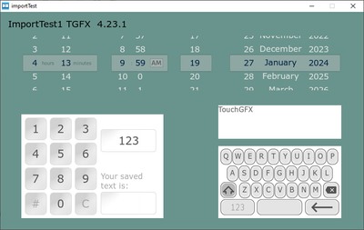

Junde
Senior III
September 30, 2024
The number keyboard and the demo show how to use it.

Junde
Senior III
October 17, 2024
alphabetical keyboard
