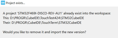

I am trying out different projects based on the F469I discovery board. Unfortunately they show up in STM32CubeIDE as having the same name, so it refused to open them.
This problem has been around for a long time, with a rather ugly workaround:

What I did (and seems to work for now) is:
1. Create project from template in TouchGFXDesigner
2. Close designer before changing anything
2. In Notepad++, do a file search and replace in the project directory for STM32F469I-DISCO-REV-AU1 to a different project name (23 occurences changed)
3. In addition, rename two files (touchgfx and debug configuration) from STM32F469I-DISCO-REV-AU1
4. Open ToughGFXDesigner, generate code
5. Double click on .project to open STM32CubeIDE
6. Build and debug.

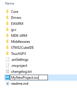

A possible solution would be to rename the .ioc file, and delete the STM32CubeIDE directory. Then open the STM32CubeMX project, regenerate code. Open TouchGFX project and regenerate code. This will result in a STM32CubeIDE project with the name you set for the .ioc file. But, keep in mind that this results in default configuration for the STM32CubeIDE project, and you have to change some of the configurations to match the project which is always created by TouchGFX.
Renaming STM32CubeMX projectRenaming STM32CubeMX project
So, I guess your current workaround might be better since it retains the project settings.
